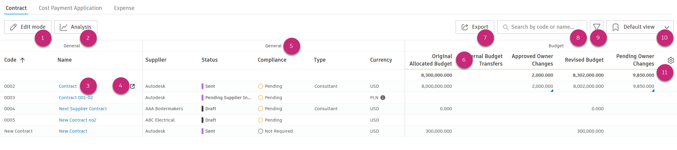

Contract overview
  1. Click the Edit icon icon to add a contract or delete one.
  2. See the charts for budget and cost trends.
  3. Click the contract name to open the flyout panel. In the flyout panel, you can edit contract details, add a scope of work, manage billing periods, attach documents, and more.
  4. Click the icon to open the contract's full page to see the detailed overview with schedule of values and change order items listed.
  5. Learn more about the five main sections of the Budget and Contract tables.
  6. Hover over the column's name to understand the logic behind them. Some of the values are also described in the Budget and Contract Tables article.
  7. Export a PDF or Excel report of your contracts.
    Tip: The Filter and Group tool may be helpful to create a more formatted report.
  8. Search through the contract table by code or name. Available for members with Collaborate, View All, or Full Control permissions.
  9. The Filter and Group tool helps to arrange efficient views of your data and create clear and legible reports.
  10. See your saved views or create ones for quick access to budget data.
  11. Control column order and visibility with the Settings icon icon.
