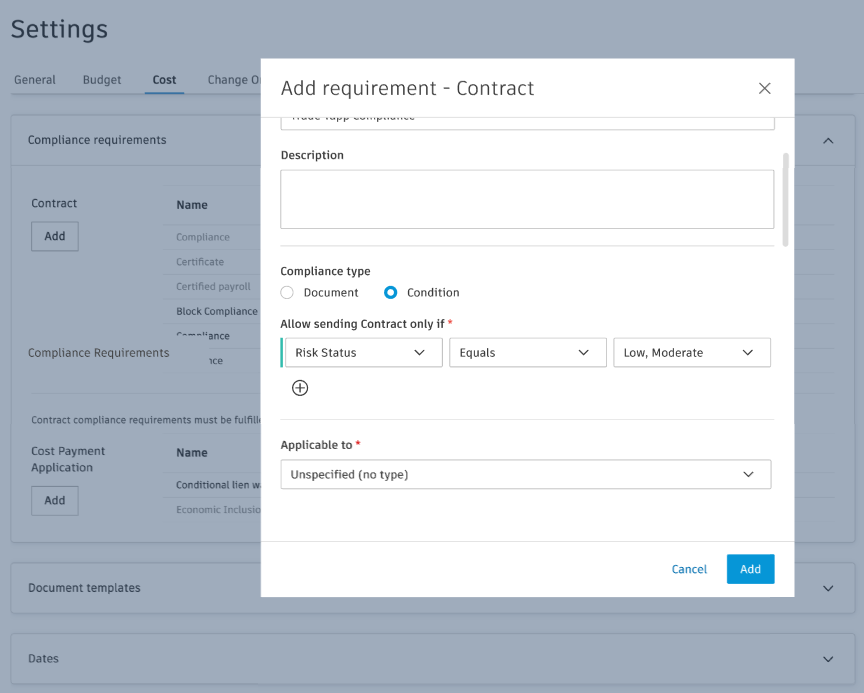

TradeTapp-based Compliance
For projects with the TradeTapp integration configured, contract compliance can be conditioned on supplier qualification and risk data synced from TradeTapp. This blocks sending a contract to a supplier whose data doesn't meet the criteria you set.
TradeTapp fields appear in the condition-field dropdowns of the Add Requirement dialog:
Add Requirement dialog showing a Risk Status condition with values selected from the TradeTapp category

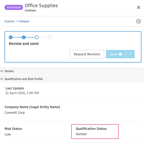

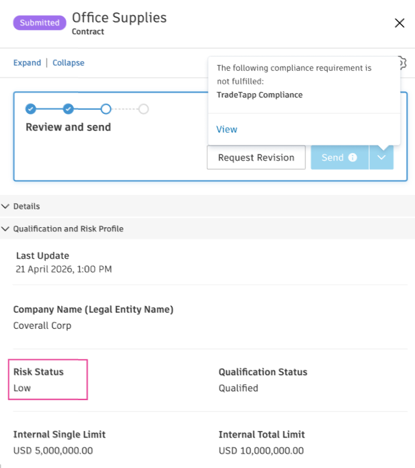

  • TradeTapp-based conditions always block sending the contract when the condition isn't met. The Block Contract Action / Allow Contract Action choice does not apply to TradeTapp-based conditions, and members can't override the block at the contract instance level. To resolve a failing condition, update the supplier's data in TradeTapp (data syncs back to Cost Management within a few minutes), or revise the compliance rule to allow the supplier's current status.
  • TradeTapp condition fields are usable only after the TradeTapp integration is configured at the hub level. If TradeTapp isn't configured and you try to save a compliance rule that uses a TradeTapp field, the system shows an error message and the rule isn't created.

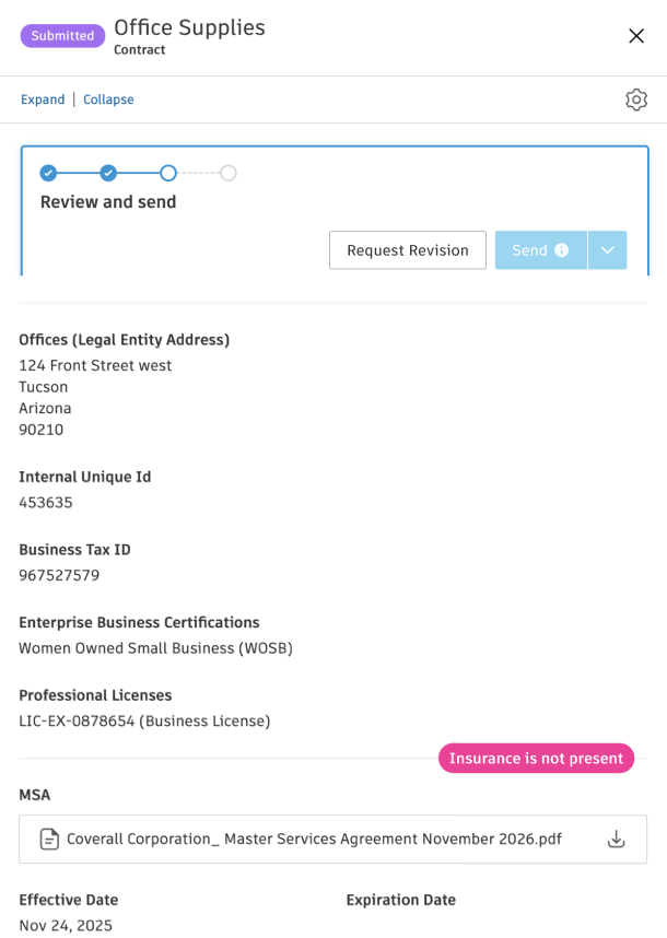

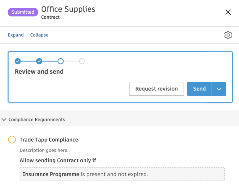

How TradeTapp Compliance Appears in Contracts
When a project has TradeTapp-based compliance requirements configured, members see the rule and its current status directly in the contract flyout panel.
