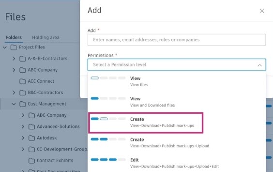

To enable adding markups to a PDF document, the project administrator has to:
  1. Select the Forma Data Management option in the General settings.
    Autodesk Docs folder option for storing generated PDF documents
  1. Grant reviewers the Create permission for the folder that stores the generated PDF document.
    Create permission setting for the folder that stores generated PDFs
