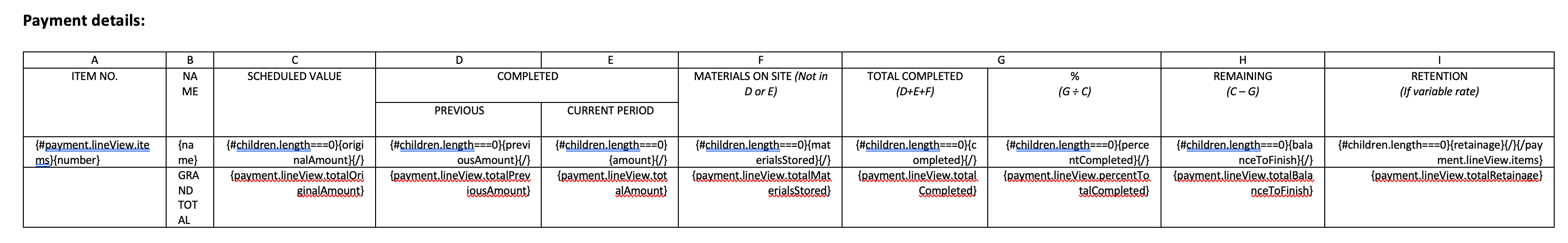

To remove empty line items from a payment application use the conditional expression {#amount!="0.00"} at the beginning of a table and {/} at the end of the line. For example:
To eliminate subtotals from payment applications or contracts, you can enter your payment line items with {#children.length===0}{xxx}{/}. For example:

Scenario: You want to create a new tab in the default cost payment application spreadsheet template that shows only scheduled items without displaying subtotal amounts.
To add a new tab without subtotal to your cost payment application spreadsheet template, use the following variable pattern:
{#children.length===0}{xxx}{/}This conditional expression ensures that only line items without subtotals are displayed in the generated spreadsheet tab. The {xxx} represents the specific data fields you want to include for each line item.
Use case: This is particularly useful when you want to provide subcontractors with a clean view of individual work items without the complexity of subtotal calculations.

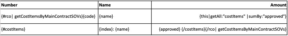

To organize CORs or OCOs by the main contract's Schedule of Values in your document template. For CORs, use this pattern:
And for OCOs, replace rco with oco.
