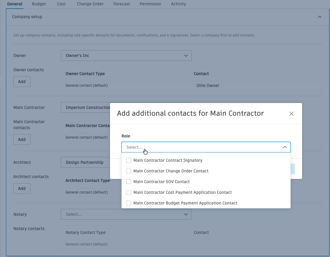

Company Setup
Company Setup defines default companies and contacts for key project roles. These contacts are used in document templates, as default recipients when sending change orders or payment applications, and in e-signature workflows.
For Owner, Main Contractor, and Architect, you can assign a General Contact plus additional contact types for specific workflows—for example, a contract signatory who signs main contracts but not every change order, or a separate reviewer for budget payment applications.
Note: If you rename Owner or Main Contractor in Additional Terms, the contact type labels in Company Setup update to match.
To configure company roles:
  1. Go to the Settings tool and switch to the General tab.
  2. Expand the Company Setup section.
  3. For each role, select the company, then assign contacts to the contact types that apply to your project:
    Owner
    • General Contact — Default owner contact for the project
    • Contract Signatory — Signs original main contract documents
    • Change Order Contact — Default for CORs, OCOs, and related change order workflows
    • Budget Pay App Contact — Default reviewer for budget payment applications
    Main Contractor
    • General Contact — Default main contractor contact for the project
    • Contract Signatory — Signs original contract documents
    • Change Order Contact — Default for SCOs, CORs, OCOs, and related change order workflows
    • SOV Contact — Reviews schedule-of-values hierarchy submissions after a subcontract is executed
    • Cost Pay App Contact — Default reviewer for cost payment applications
    Architect
    • General Contact — Default architect contact for the project
    • Change Order Contact — Default for CORs, OCOs, PCOs, and related change order workflows
    Notary — Used for document templates that require notary information. Assign one company and contact.
Company Setup showing multiple contact types for Owner, Main Contractor, and Architect roles
Tip:
  • If your project process role is Contractor, the Main Contractor field auto-populates with your company. If your role is Owner, the Owner field auto-populates. You can override these values if needed.
  • The company dropdown initially displays approximately 50 companies. To find a specific company, start typing in the search field to filter the list. When you select "Search in hub company directory," your filter criteria will carry over.
  • If a workflow-specific contact type is empty at a given level, Cost Management falls back to the General Contact for that role at the same level.
Note: When creating a project from a template, only your company ID is inherited based on your role (Owner or Contractor). You'll need to manually configure all contacts (Owner, Contractor, Architect, Notary) and set the Architect and Notary company IDs.

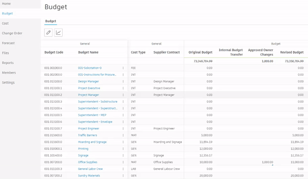

Budget and Contract Allocation
Members can add multiple budgets to a single contract by default. Here is the diagram that demonstrates the relationship between budget and contract allocations when this option is chosen:
Multiple Budgets to One Contract
For all diagrams presented in this section of the article:
Clicking Assign the same budget to multiple SOV items when the option of Multiple budgets to one contract is on helps organizing your budget and contract items differently but still connected. It allows multiple contract items to link to the same budget item:
Assign the Same Budget to Multiple SOV Items
Note: When this feature is turned on, change orders won't appear as separate columns in your contract view or cost payment applications.
To restrict this, select the One budget to one contract option. This option limits each contract to a single budget code:
One Budget to One Contract
Note: Enabling this setting keeps accounting integrations unaffected.
Alternatively, you can allow a single budget to be allocated across multiple contracts. When this option is enabled, project members will be prompted to specify a contract each time they select a budget for the following:
One Budget to More than One Contract
Note: These options use checkboxes, not single-choice buttons. You can select more than one option. When you select the second option, the first option is automatically included. And if you select the third option, both the second and first options are automatically included.

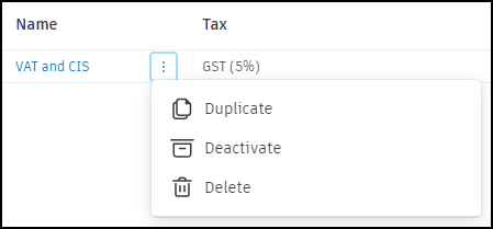

Tax Formulas
Use the custom tax calculation feature to calculate taxes in all cost processes and show tax in the generated cost documentation to comply with government requirements. Project administrators can add multiple tax formulas to control how taxes are applied for each contract, payment application, and change order. Any existing formulas will be available in the list.
Create a Tax Formula

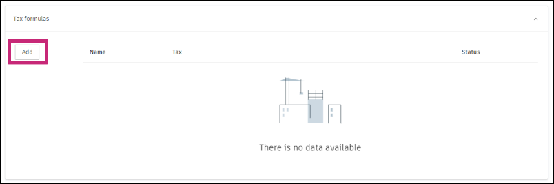

To create a tax formula:
  1. Within Cost Management, click Settings from the left navigation.
  2. On the General tab, click Tax Formulas, and then Add.
    Cost settings tax formulas

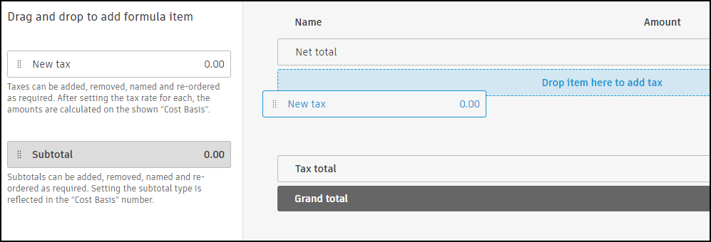

  3. Select the pencil icon to edit the formula's name.
  4. To update the net total default (1,000.00) in the center preview panel, click Net Total.
  5. Drag a new tax into the center column to add to the formula.
    Add new tax
  6. Click newly added New Tax to specify the Tax Rate as a percentage. The tax rate can be positive or negative. Negative tax rates are useful for figuring out CIS deductions.
    Edit new tax
    Important: If taxes in different tax formulas have the same name, they'll be combined into a single tax in the tax summary regardless of the tax rate.

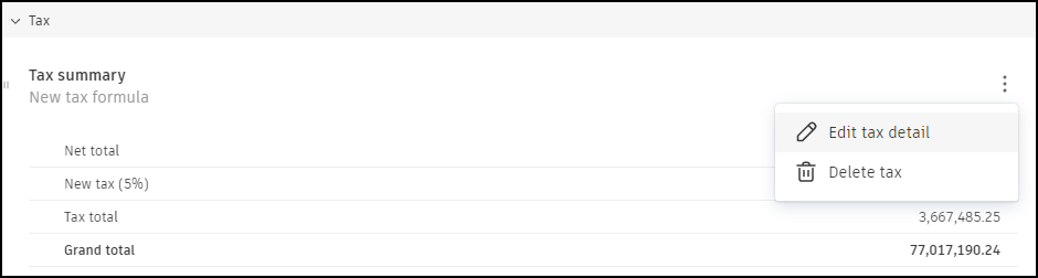

  7. Continue adding more taxes as needed to build out your formula. As you add taxes, the tax total is calculated based on the tax rate and the net total. Combined, these values produce the grand total. Taxes can be added, removed, named, and reordered as required. After setting the tax rate for each, the amounts are calculated on the Cost Basis column.
    Note: You can add a taxable base limit. This limit determines the maximum amount of income that can be subject to taxation within a specific period.
  8. Drag a new subtotal into the center column to add to the formula. The subtotal is used to support a tax-on-tax use case.
  9. On the right panel, you can choose between two options:
    • Revise Cost Basis to recalculate the cost basis for subsequent taxes.
    • Info Only to have the subtotal visible for informational purposes without recalculating the cost basis for subsequent taxes.
    New subtotal
    Note: If there are multiple taxes above the subtotal, the subtotal will display both the tax subtotal and the subtotal.
  10. Click Save to save the tax formula.
To show tax in the generated cost documents, the document template will need to be updated with the new template available in settings.
Edit and Manage Tax Formulas
After the tax formula is created, you can use the More menu Vertical more menu icon to modify the formula by:
Cost tax formula more menu
Note: Tax formulas that have been applied to items can't be edited, deactivated, or deleted.

  1. Click the relevant Cost, Budget, or Change Order tool from the left navigation, depending on where you are applying the tax.
    Note: Make sure you added your tax formulas in advance. See the Create a Tax Formula section to learn more about adding tax formulas.
  2. Click the relevant tab. Available options are:
    • Contract
    • Cost Payment Application
    • Main Contract
    • Budget Payment Application
    • PCO
    • OCO
    • SCO
  3. Click a line item's name to open the details panel.
  4. In the details panel on the right, scroll to the Tax section and click Apply Tax. If you only have one tax formula available, that formula is applied to the expense. If you have multiple tax formulas, select the formula to apply.
    Apply a tax details panel
    The applied tax is visible in the tax summary for the line item.
    Tax summary details
    Note: You may see a message indicating the base data was modified. In that case, you'll be prompted to recalculate the applied tax. Several things can lead to the prompt to recalculate, depending on where the tax is being added:

  5. If necessary, use the More menu Vertical more menu icon and choose Edit Tax Detail or Delete Tax.
    Cost tax more menu
    Editing the tax details allows you to turn on or off specific taxes as needed. The change is automatically updated in the Tax summary table.
