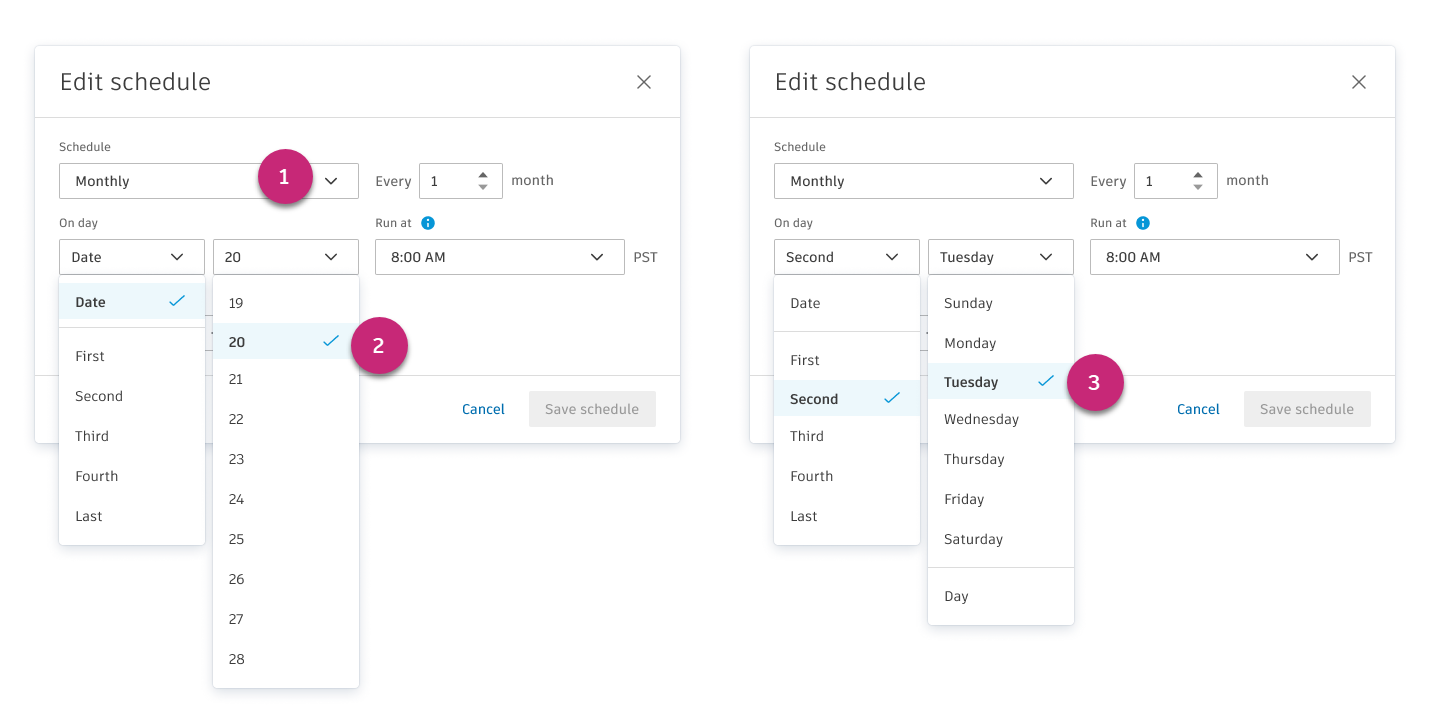

Schedule Budget Snapshots
Set up automatic snapshots to capture budget data at regular intervals. You can configure the frequency, day, time, and duration for which snapshots should be taken:
  1. Choose between weekly or monthly snapshots.
  2. Specify the day of the week for weekly snapshots. For monthly schedules, snapshots occur only once per month.
  3. For monthly schedules, define the specific instance of the day within the month (for example, first, second, or last). The default value is first. For example, selecting second Tuesday schedules the snapshot for the second Tuesday of each month.
Budget snapshot setting
When configuring snapshots, you’ll receive an estimate of how many snapshots will be generated within the specified time frame.
Note: Only one budget snapshot schedule can be active at a time.
To delete a schedule, click Edit schedule, and then select Remove schedule.
Snapshots are accessible in the Budget tool, where you can filter between manually and automatically created snapshots. Learn more about Budget Snapshots.

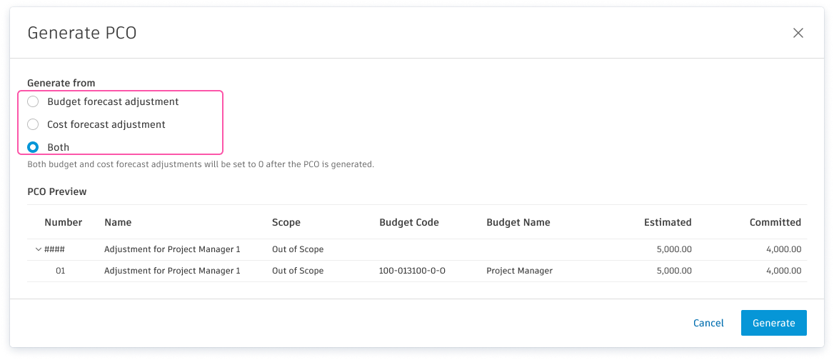

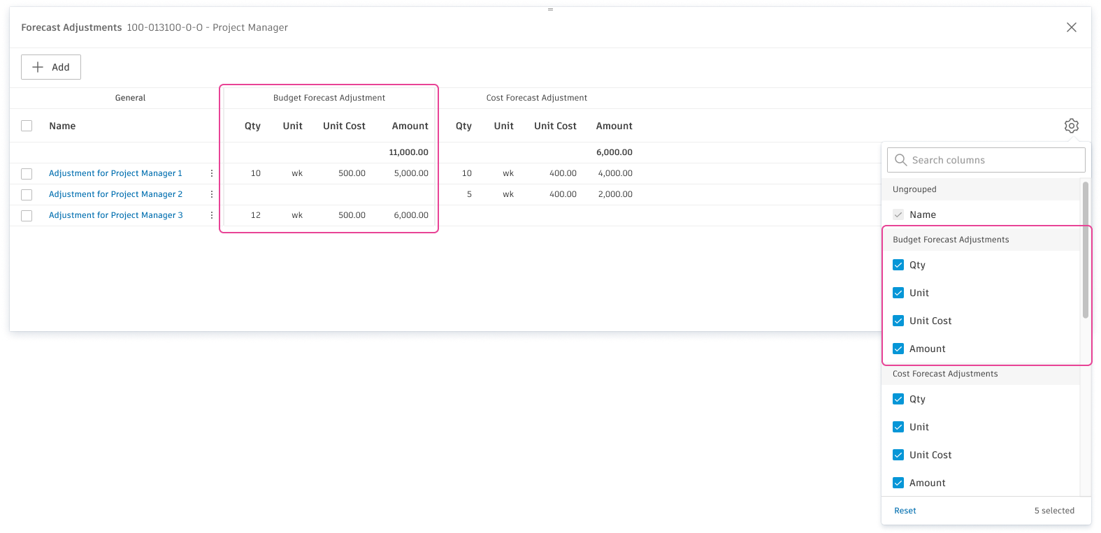

Budget Forecast
Budget forecast allows you to forecast both revenue and costs, providing visibility into projected fees by calculating the difference between forecasted budget revenue and forecasted costs. This enables general contractors to manage scenarios where time-related resources may change (such as increased hours) without exceeding the Guaranteed Maximum Price (GMP), requiring either change order transfers or internal budget transfers.
Turn on to show budget forecast columns and allow budget forecast adjustments. Recommended when using a cost plus main contract.
If the toggle is on:
Note: This setting cannot be turned off once Forecast Final Budget is selected as the distribution curve in the cash flow settings. See Forecast Settings to learn more.
