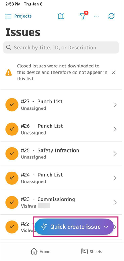

  4. Tap the Quick create issue button in the bottom left of the issues list.
    Quick create issue button in the Issues list

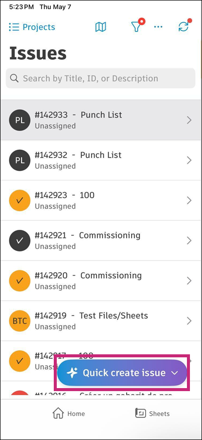

    • From the Project home page, tap the Quick create issue shortcut.
      Quick issue shortcut on the Project home page

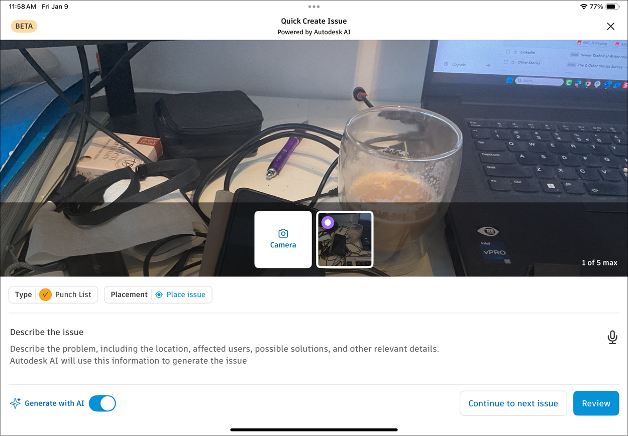

  5. The camera opens automatically. Take a photo of the issue.
    Tip: You can also select images from your device library by tapping Photo library icon in the bottom left of the screen.
    Note: The issue is created when you take or select the first photo. You can add up to five photos for AI processing.
     Quick Issue Creation Photo Taken

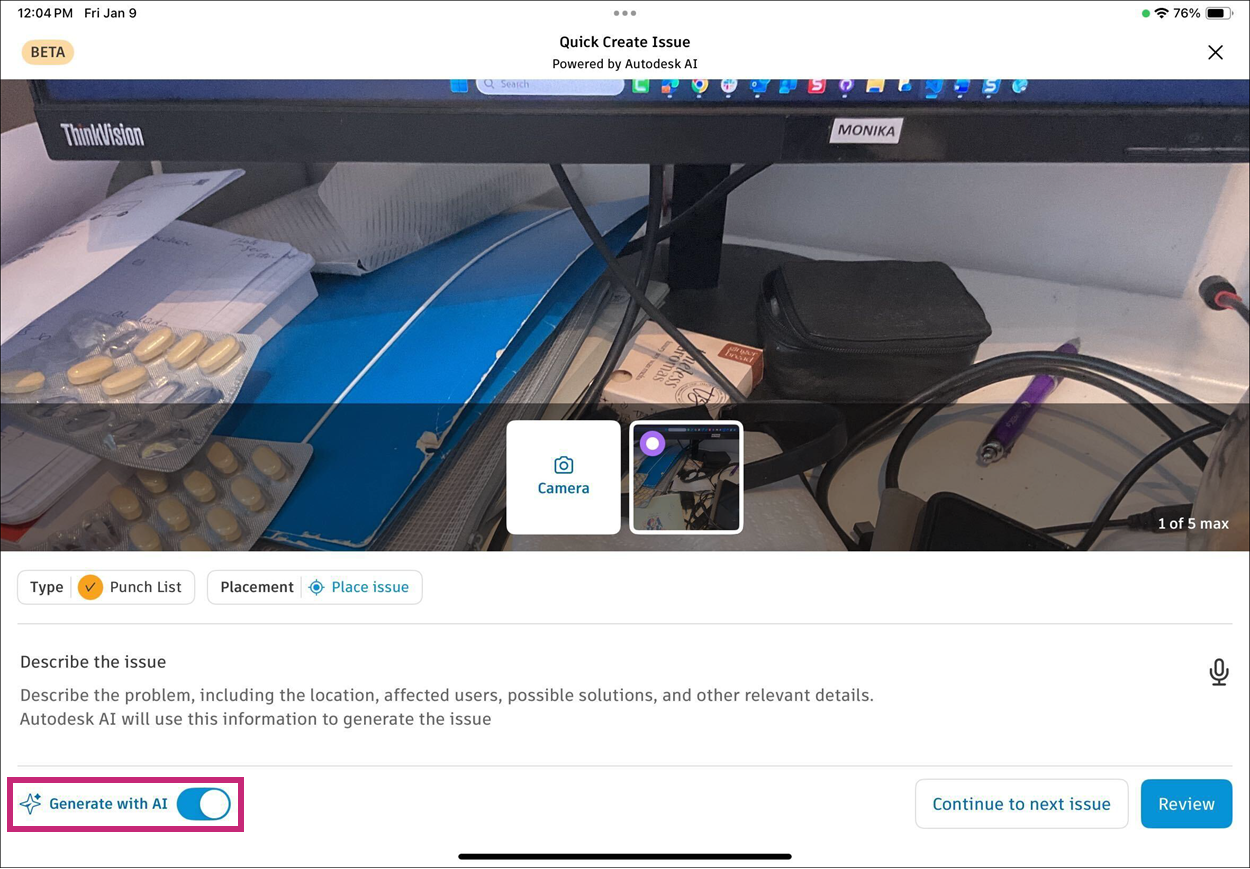

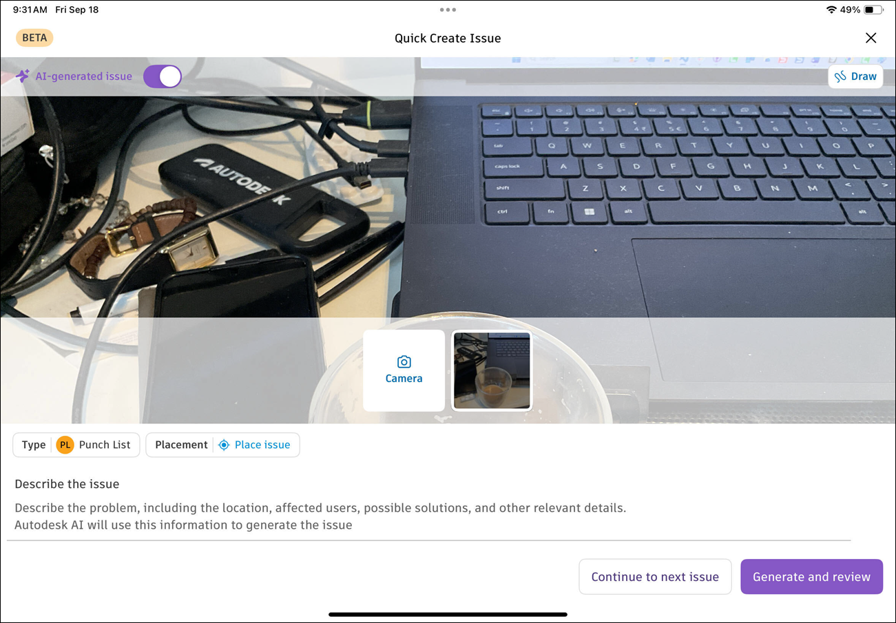

  1. In the Quick Create Issue view, add the following details about the issue:
    • Photos: Tap the camera icon to add more photos. Tap any attached photo to view or delete it. You must keep at least one photo.
    • Describe the issue: Enter a short description. You can type or use speech-to-text. This description helps AI understand the issue context.
    • Type: Select the issue type. The default is Punch List. Your selection stays the same for the next issue you create.
    • Template: Select an issue template instead of a type. AI keeps the values set by the template and doesn't change them.
    • Placement: Add a placement on a sheet or file. The last sheet or file you opened appears by default.

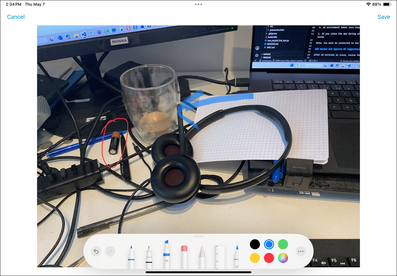

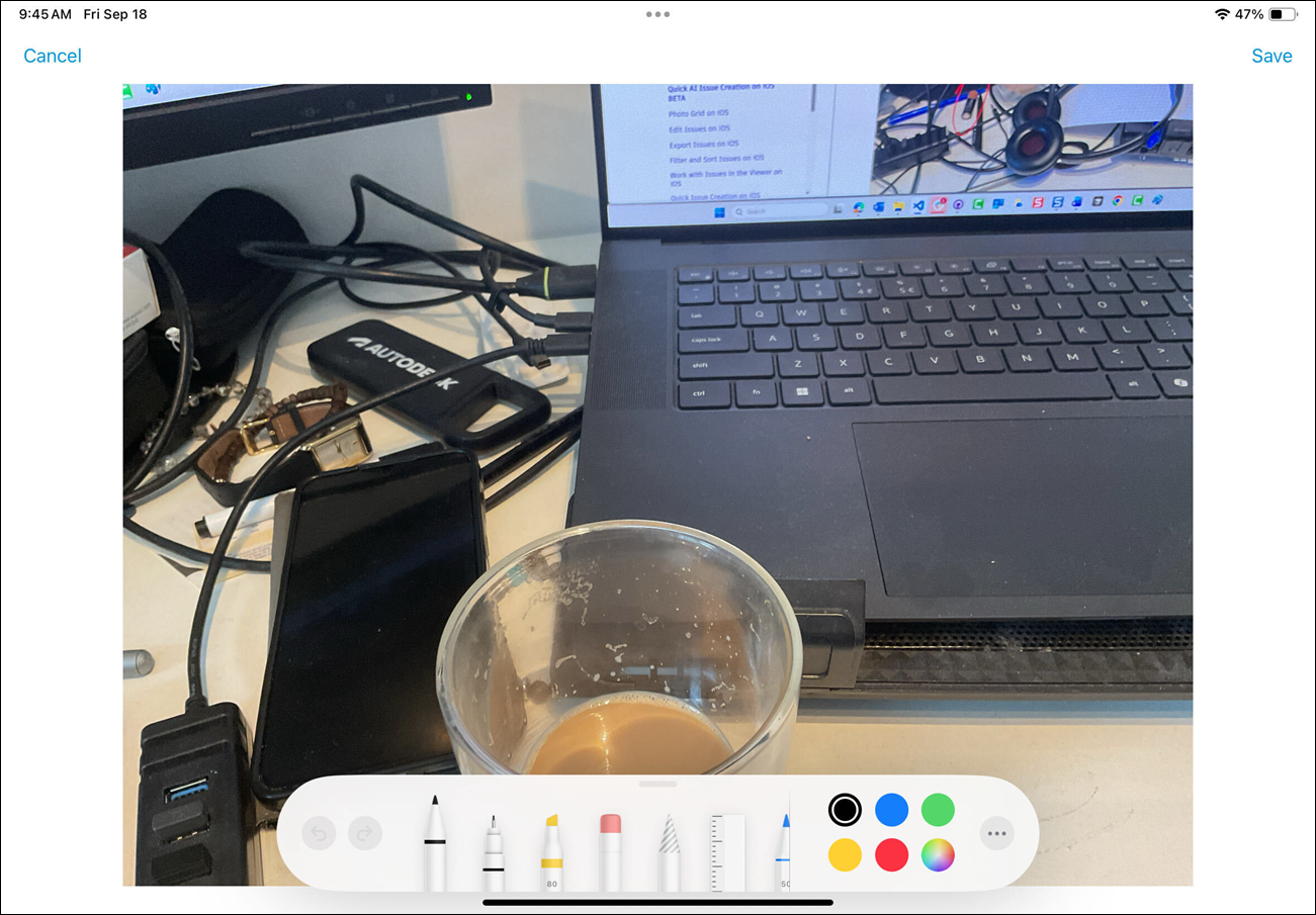

    • Draw: Add markups to your photos if needed. Tap Save to save your markups.
      Ios Quick Issue Creation Draw Option

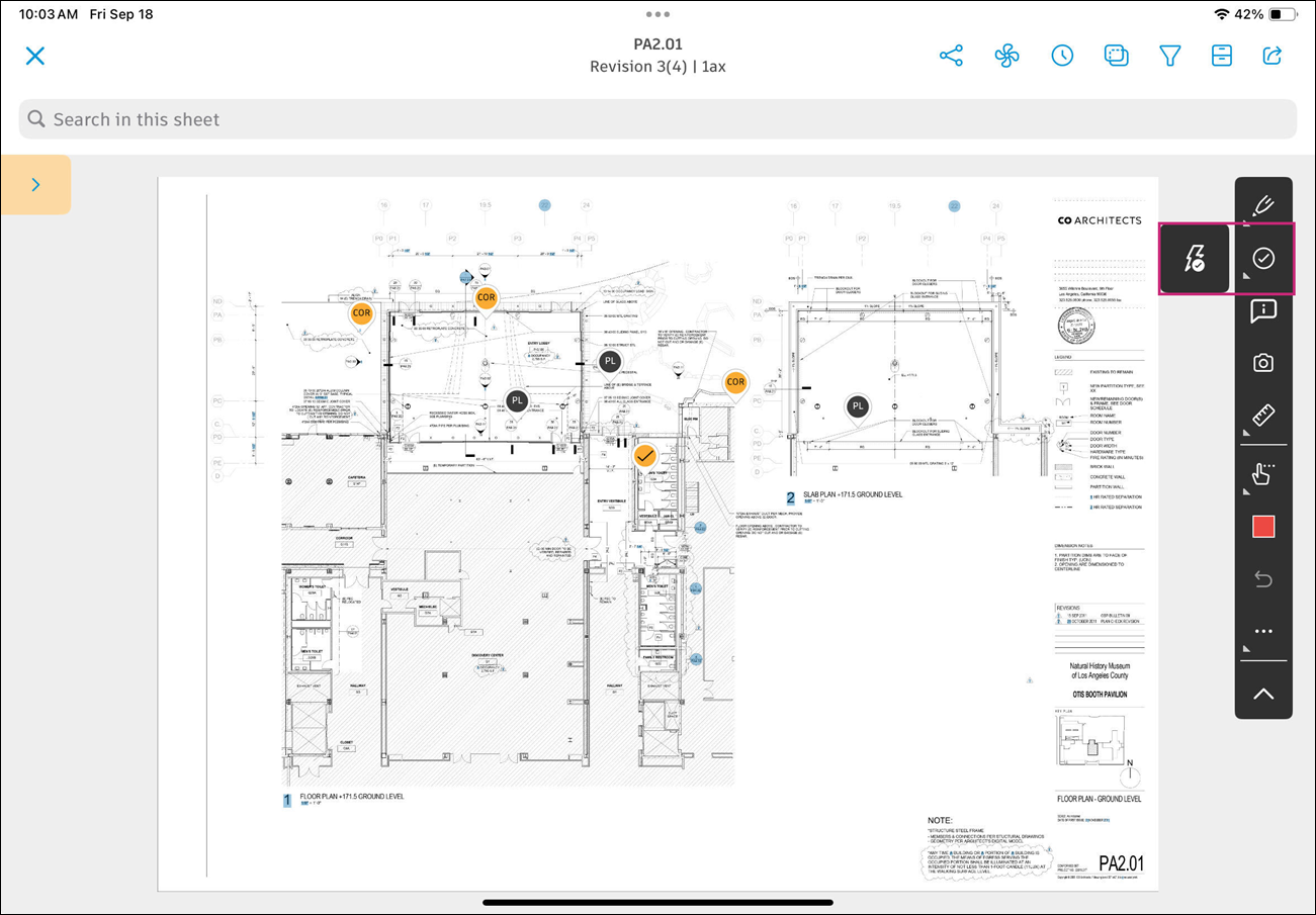

Create issues from a sheet or 2D file
You can also start Quick AI issue creation in the viewer. Place the issue pin on the sheet first, then take the photo. This helps when you capture many issues during a site walk.
Note: This entry point works on sheets and 2D files. It isn't available for 2D views of 3D models.
  1. Open a sheet or 2D file in the viewer.
  2. Tap and hold the Issues icon on the markup toolbar.
    Tap and Hold Issues icon
  3. Tap the quick issue creation icon, then tap the sheet or file to place your issue.
    Long press quick issue creation icon
    Tip: Your selection is remembered for the next issue. Press and hold again to switch back to regular issue creation.

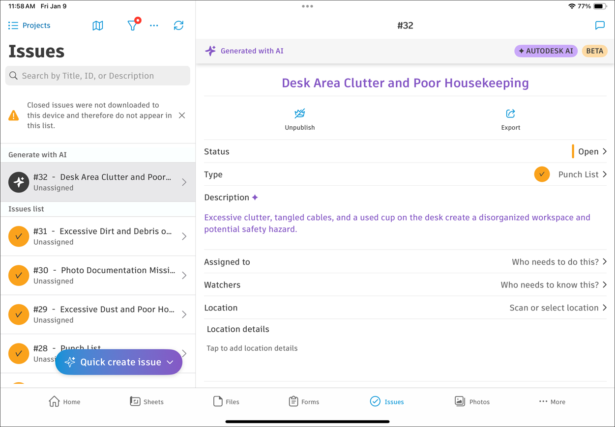

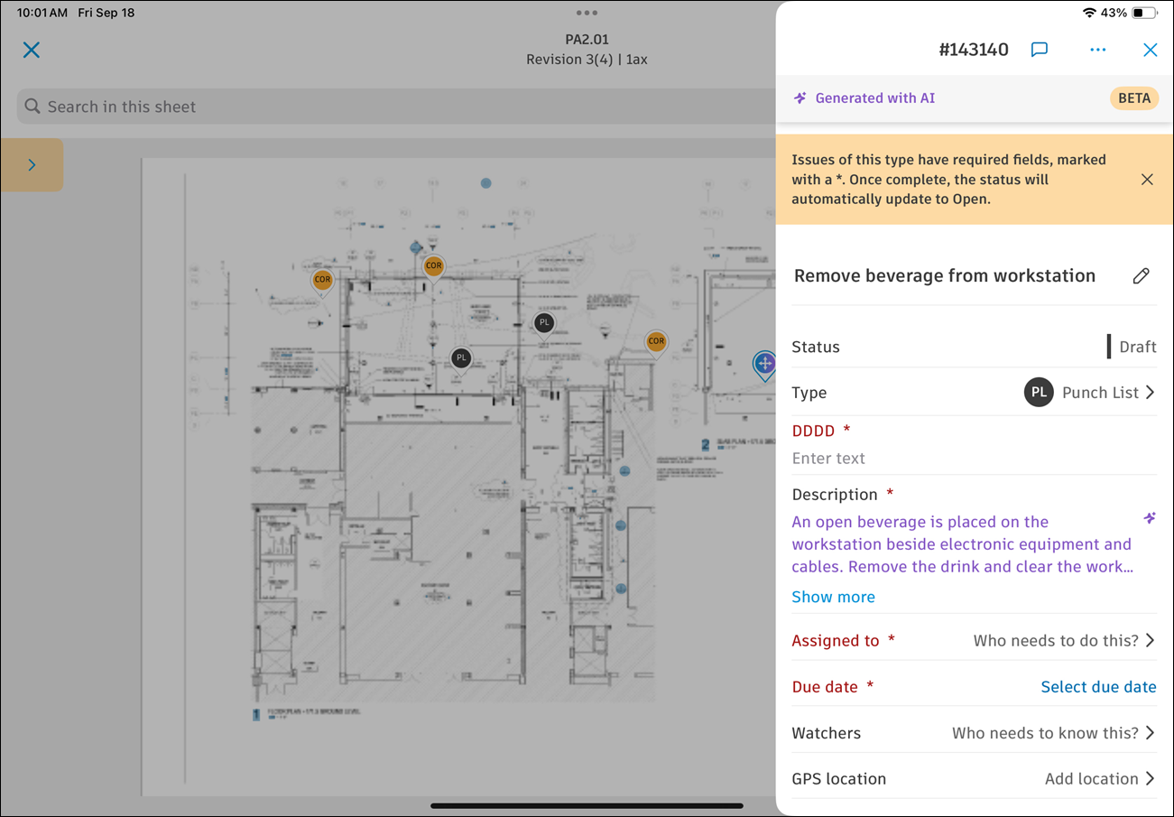

After you create an issue, AI analyzes your photo and description to fill in issue fields automatically.
  1. AI enriches the issue details, which appear marked in purple:
    Issue details filled in by AI and marked in purple
    Note: AI doesn't fill in location, location details, placement, or references. Add these details yourself. Values set by a template aren't marked in purple.

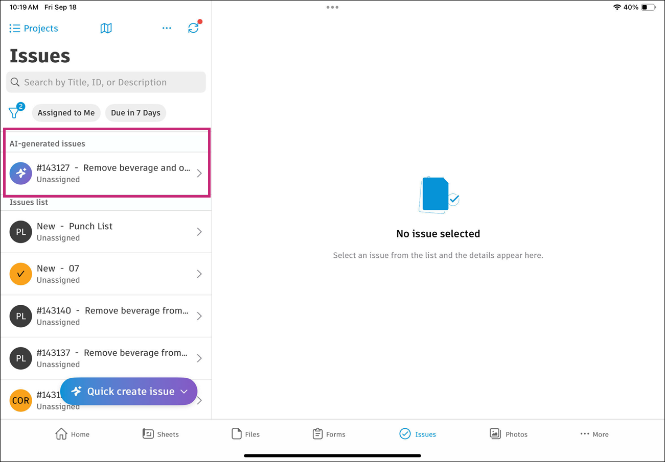

  2. Issues being enriched by AI always appear at the top of the Issues list and have the icon shown below.
    Issue Enriched by AI top of list

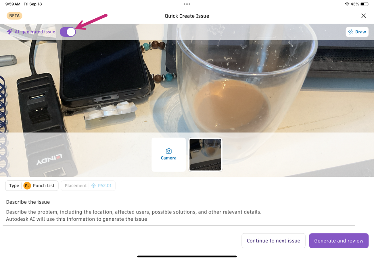

Generate without AI toggle
You can turn off AI enrichment while still using the quick create flow.
  1. In the Quick Create Issue view, locate the Generate with AI toggle in the top left of the screen.
  2. Turn off the toggle. The Quick Create flow continues without AI enrichment:
    • The Describe the issue field becomes a standard Description field.
    • You can add unlimited photos.
    • You can still select an issue type or a template.
    • When you tap Create & review, the issue is added to the Issues list immediately.
  3. The toggle setting remains the same for your next issue.
    Note: If your hub doesn't have AI features enabled, you won't see the Generate with AI toggle. You can still use Quick Create to add issues faster without AI enrichment.
    AI issue creation toggle
