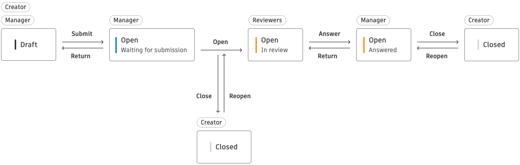

Default RFI Workflow
The standard RFI workflow with Creator, Manager, and Reviewer roles is fully supported for Bridge sharing.
Default RFI workflow

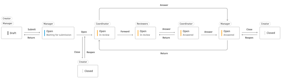

RFI Workflow with Coordinator
The enhanced workflow that includes an RFI Coordinator role is also supported for Bridge sharing.
RFI workflow with Coordinator
