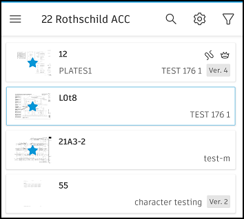

Add and View Favorite Sheets on Mobile
You can add commonly used sheets to your favorites to display them at the top of your sheets list for easy access.
  1. Tap the relevant sheet.
    • Android: Tap the More menu at the top right
    • iOS: Tap
  2. Tap Add to favorites.
When you access your sheets list or grid, your favorites will be marked with a star and listed at the top.

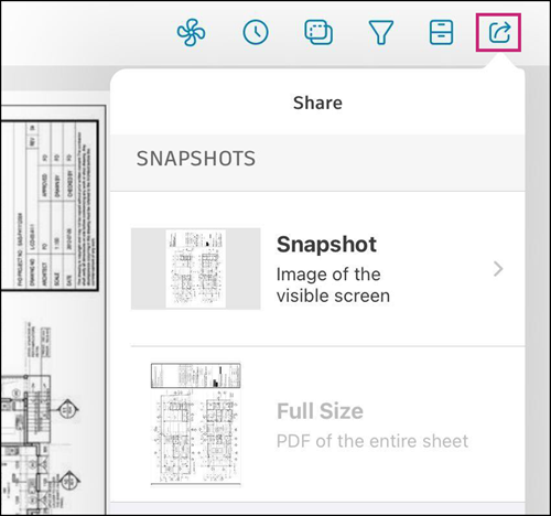

Share Sheets on Mobile
Members can share a snapshot of a sheet, or a full-size PDF of the entire sheet. This can be useful if you want to share a sheet comparison or a sheet with markups with other members.
  1. Tap the relevant sheet:
    • Android: Tap the More menu at the top right and tap Export.
    • iOS: Tap the following icon:
  2. Select either a snapshot of the visible screen, or a full-size PDF of the entire sheet.
  3. Tap on the desired thumbnail to view the following share options:
    • Email.
    • Open in: Full size only. This allows you to share using other apps.

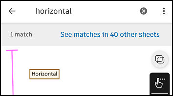

Search Sheets on Mobile
You can search your entire sheet list for sheet number, title, and in the sheet content. You can also search for content in a sheet you've opened in the viewer.
Search the sheets list
In the sheet list, enter the text you want to find in the search box. The results are split into two tabs:
Search sheets in the viewer
Tap the relevant sheet and enter the text you want to find in the search box.
The search results will automatically display the number of matches returned. All search matches are outlined in brown. You can also tap on the link for any search matches made in your other sheets.

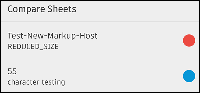

Compare Sheets on Mobile
  1. Tap the Sheets icon .
  2. Tap one of the sheets to compare:
    • Android: Tap
    • iOS: Tap
  3. In the Compare Sheets dialog box, select the second sheet.
    The sheets are overlaid on top of one another and you can toggle between the differences shown in red and blue.

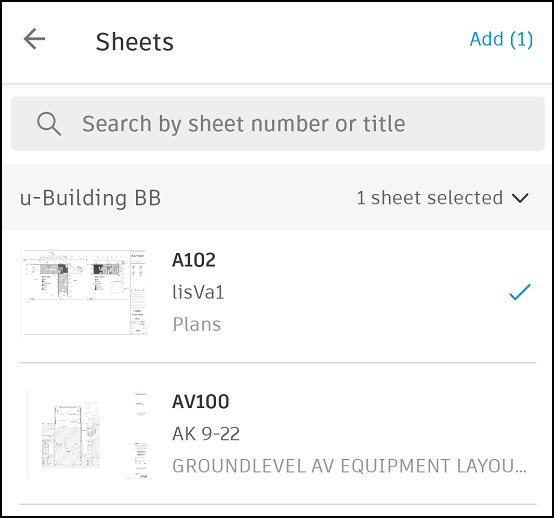

Sheets References
You can add sheet references to items in other tools on mobile to provide supporting information or extra detail. For example, you can add a sheet reference to an RFI.
  1. Tap the relevant tool (for example, the RFI tool).
  2. Select the relevant item or create a new item.
  3. In the References section, tap + Add next to Sheets
  4. Search for the relevant sheet, or select a collection that contains your sheet.
  5. Select your sheet or sheets.
  6. Tap Add(x) at the top right.
    The referenced sheets will be displayed under the References section in the relevant item.
