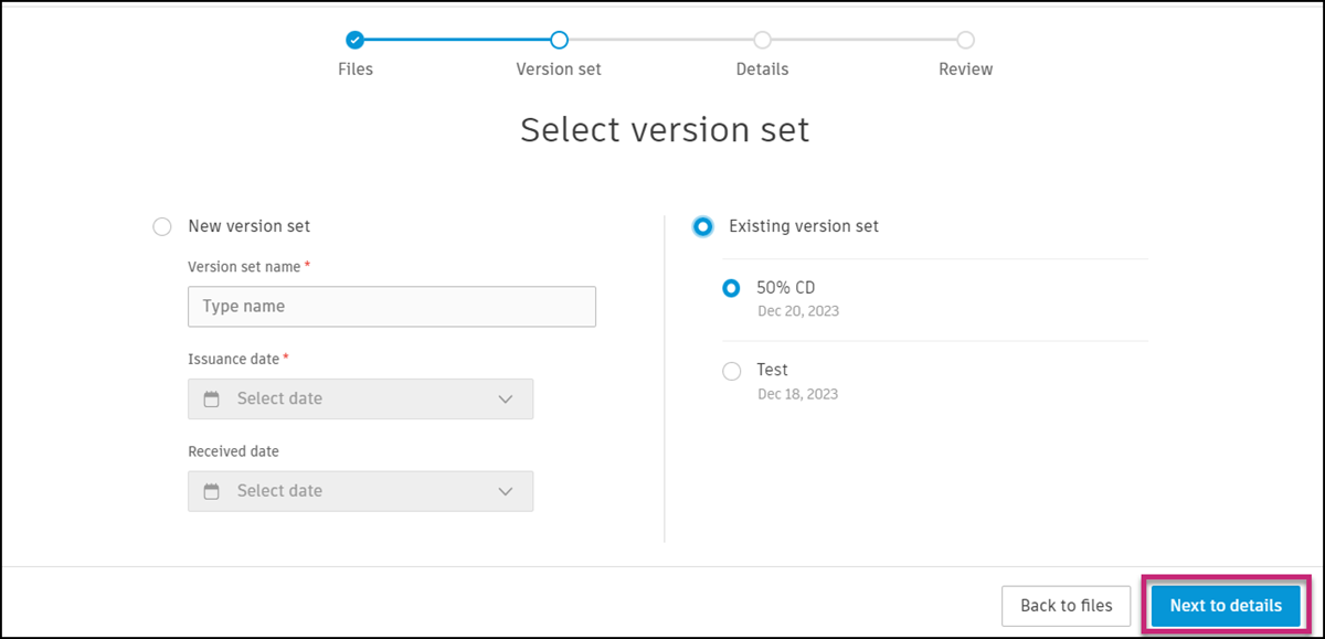

After you've added your specification in the PDF format, the second step involves selecting a version set to group certain specification versions together.
As version sets can be created during the specifications publishing process, they don't need to be created in advance. However, members with Create permission or above may want to configure version sets ahead of time for other project members.
If this is a new version of specifications, you need to create a new version set. Enter a version set name and the following dates:
If you want to add your specifications to an older version set, select an existing version set.
Click Next to details to proceed to the next step.
Click Back to files to go back a step to Add Specifications.
