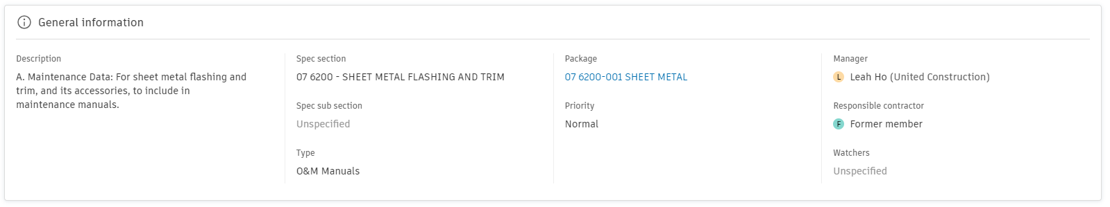

The general information shows basic details about the submittal item, such as description, type, and spec section.

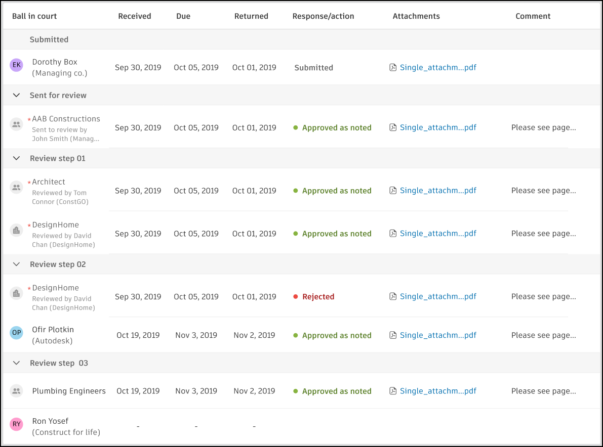

The workflow table summarizes the workflow with important dates, attachments, and comments.
In review steps that are in progress or completed, the table lists reviewers who have already responded first, in the order of their response.
Use the response and action column to act on the submittal item, such as approving it or requesting revisions.

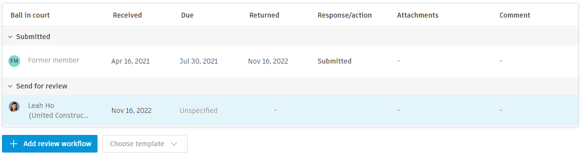

Select a Review template or edit the review workflow for the submittal item.
Add up to 30 required reviewers and 20 optional reviewers to each review step. A workflow can have up to 6 steps.

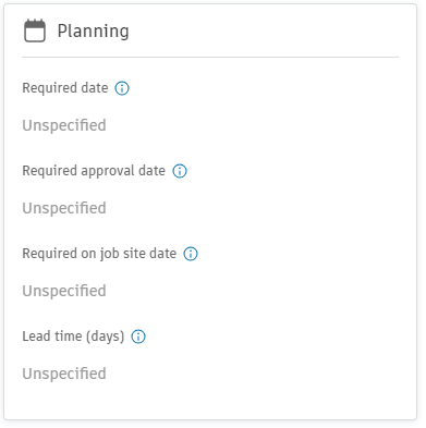

Plan around required dates
The planning dates help you plan and schedule:
Required date
Required approval date
Required on job site date
Lead time

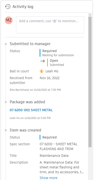

Review the history of all activity related to the submittal item.
Comment and @mention others to collaborate.

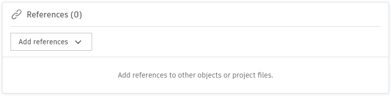

Link the submittal item to other project elements, such as Assets, Files, Forms, Issues, PCOs, Photos, RFIs, other Submittals, Schedule, and Sheets. References keep the submittal aligned with other project components.
Add references to Submittals on mobile
Add references to Submittals directly from the Forma app.
Open any tool other than Submittals.
Tap Add reference where all references are listed.
Select the Submittal item you want to link.
Tap Save.
References you add on mobile sync immediately with the web application, so all team members have access to complete submittal information.

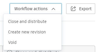

Close, revise, or void a submittal item
Close and distribute
Click Close and distribute to conclude the review of a submittal item. The system distributes the submittal information to all individuals involved in the process. Closing shows that reviewers have reviewed the submittal and provided the necessary feedback or approval.
You can share Closed submittals to the Files tool. Once in Files, you can share the submittals to another Autodesk Forma project using Bridge and manage the shared items in the Bridge tool.
Create a new revision
Click Create new revision to create a new version of the submittal item. When you create a new revision, you can:
Assign a Responsible Contractor.
Set a due date for the submitter.
Add watchers who need to be informed or monitor the submittal.
Important: Submittal Managers and Project Administrators can create new revisions or close submittals regardless of their status, except for items marked as Draft or Void.

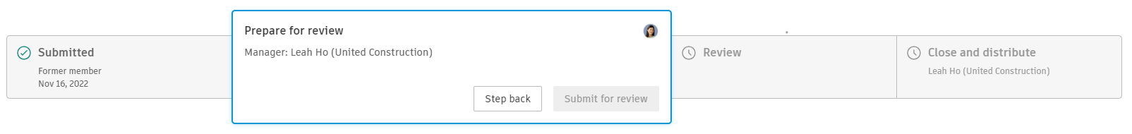

Step back to the responsible contractor
You can step back an item in Open status to the Responsible Contractor. This lets you correct an item you created in Open Submitted status. The step back is recorded in the activity log as a standard entry.
If an attachment upload fails when you create an item, the item still exists. Step it back to the Responsible Contractor, and submit it again.
Void a submittal item
Click Void to invalidate a submittal item that's no longer relevant or necessary for the project. Don't consider a voided submittal item in ongoing project activities.
