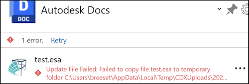

SCIA Engineer
- Starting with Desktop Connector 16.7 release, the SCIA Engineer authoring application will no longer prompt the user to delete the temporary files created by SCIA Engineer.
- Files open in SCIA Engineer are locked from reading by other processes and therefore Desktop Connector will fail to upload files as long as they are open in SCIA Engineer. You may see an error in the Desktop Connector Home Screen similar to below when saving files from SCIA Engineer. Close the file and either manually retry the failed job or wait for Desktop Connector to automatically retry the job.
