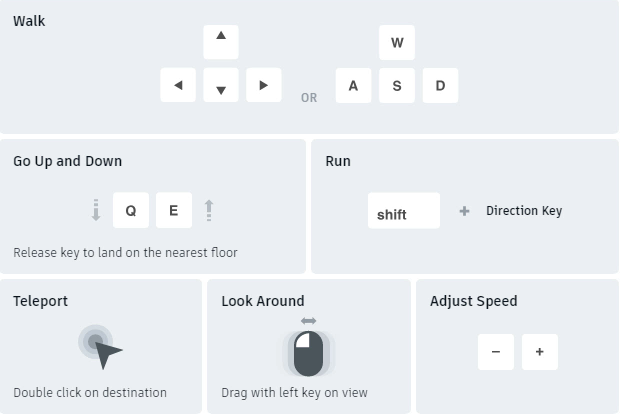

  5. Review the first person navigation controls and click in the whitespace to move to the project model.
    Tip: The navigation controls are presented each time you use the first person navigation. If you become familiar with the navigation controls, you may dismiss this message in the future.
Now you are placed into the project model in first person mode at the location and viewing angle selected from the 2D sheet. From here, you can walk around the model or quickly jump back to the previous view to return to the corresponding 2D sheet. While in first person mode, you cannot select objects. Exit first person mode to make a selection.

  2. In the display toolbar at the bottom of the screen, click the First Person icon .
  3. Review the first person navigation controls and click in the whitespace to move to the project model.
    Tip: The navigation controls are presented each time you use this feature. If you become familiar with the navigation controls, you may dismiss this message in the future.
