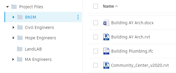

The third method of sharing models involves linking directly to the model in the Files tool. Since you're linking to the model that is actively being updated, it is referred to as live linking.
To share using the live linking method:
Add all teams and members you're sharing the model with to your Team folder in Design Collaboration.
Make sure that each member has at least View only permission for the Team folder.
Make sure that each member has at least View + Download permission for the folder containing the model in the Files tool.
Link directly from Revit to the model in the Files tool.
(Docs/Build://Project Name/Project Files/Team Name/FileName.rvt).
