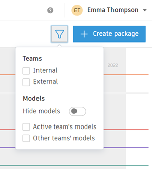

Filter the Project Timeline
By default, the Project timeline shows a combination of packages and models from your team and those shared by other teams. You can filter the Project timeline to hide certain data.
  1. Click the handle at the top of the screen to open the timeline .
  2. At the top right of the screen, click the Filter icon.
  3. If you have bridged projects and team automations set up for your project, use the Internal and External options to see only local teams or only bridged teams.
  4. Toggle the Hide models option to hide linked models from other teams. Packages shared by other teams are always displayed.
  5. Use the Active team's models option to display only models published by your team. Or use the Other teams' models option to display only linked models from other teams. Packages from your team are always displayed.
