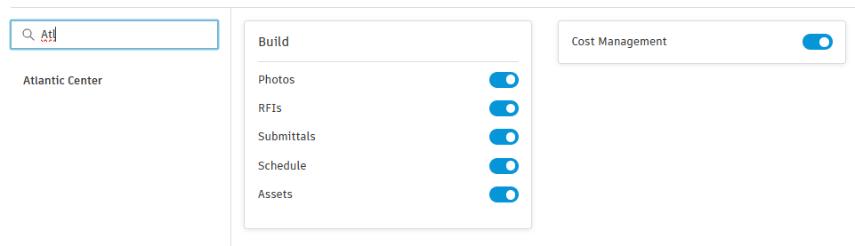

Turning on and off tools in projects
  1. In Account Admin go to Products and tools on the left.
    Side navigation
  2. Select a project. You can use the search to reduce the project list.
  3. Click the toggles to turn on or off the desired products or tools.
    Toggles
