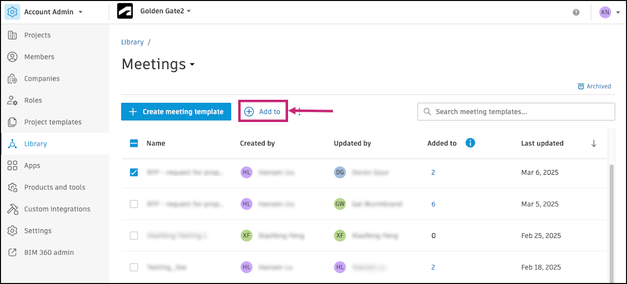

You can also add a template to your project later using the template list:
  1. Select a template or several templates from the template list.
  2. Click Add to. You will be redirected to Not added to tab with projects to which the selected template or templates have not been added.
  3. Search for a project by name or filter projects to display only archived, or only selected ones.
  4. Once you've selected a project or projects, click Add to to add a template or templates.
  5. A confirmation modal will then display the projects that you have selected for the meeting template or templates to be added to. To confirm, click Add.

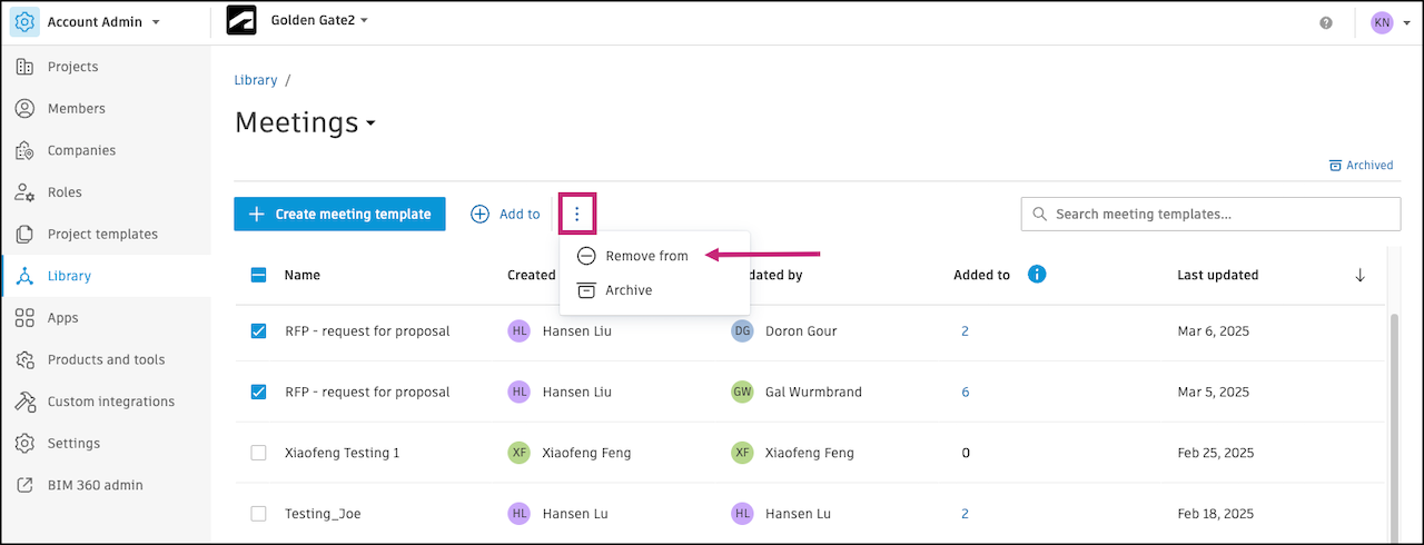

Remove Meeting Templates from Projects
  2. Click the More menu at the top of the table and select Remove from. You will be redirected to the Added to tab with projects that use this template or templates.
    Note:
    You can also remove a template from a project by clicking on a template and clicking the More menu icon More menu icon in the right panel to perform the same action.
  3. Search for a project by name or filter projects to display only archived or only selected ones.
  4. Once you've selected a project or projects, click Remove from to remove a template or templates.
  5. A confirmation modal will then display the projects that you have selected for the meeting template or templates to be removed from. To confirm, click Remove.
