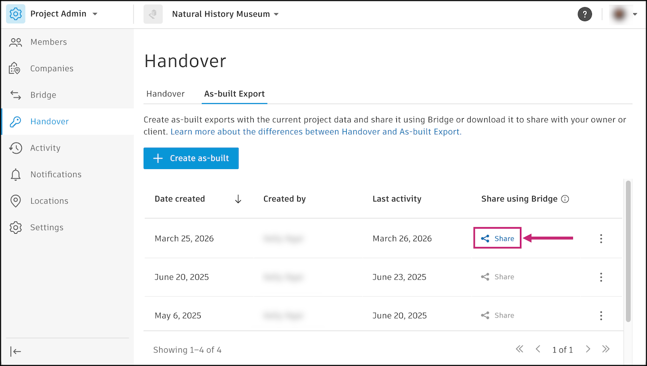

  1. Click Share on the As-built Exports log.
