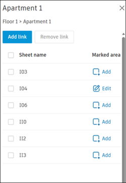

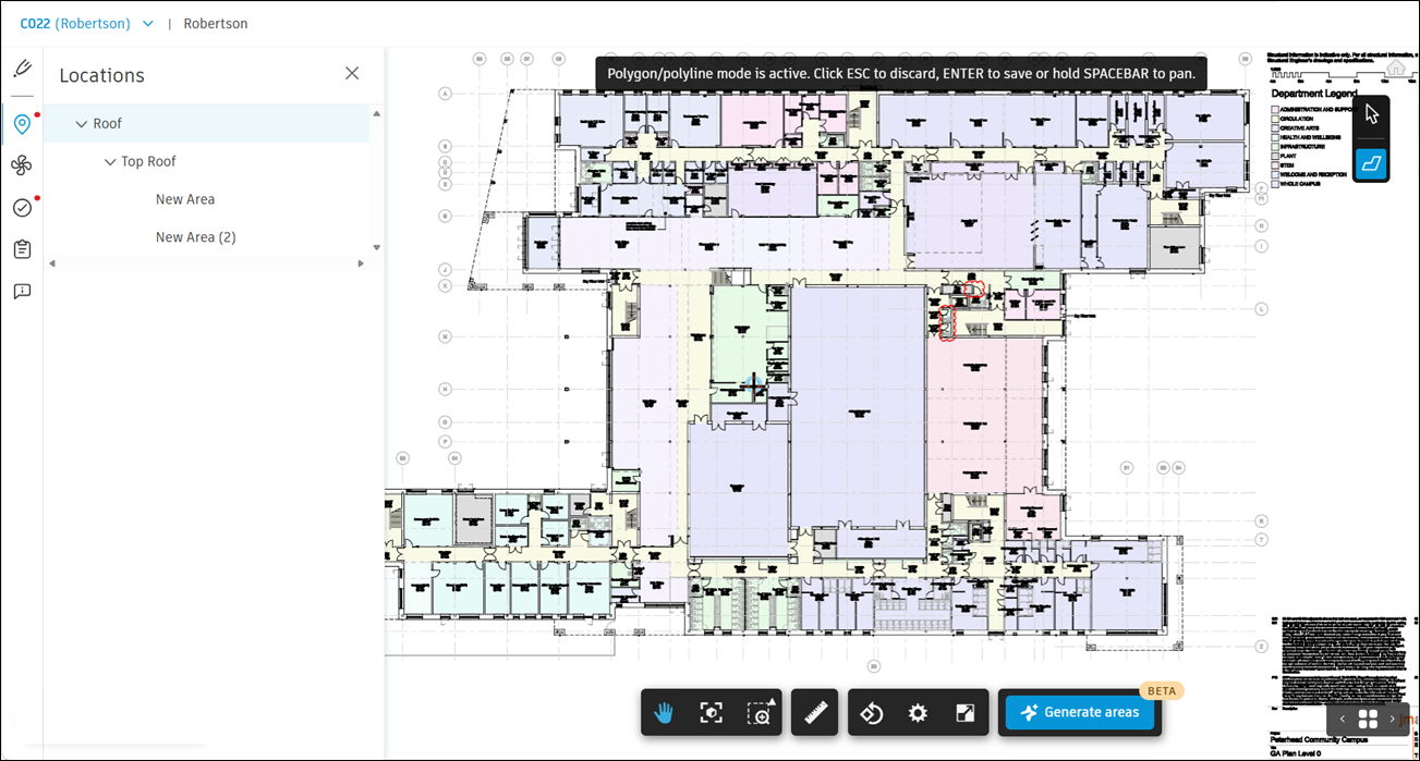

Open a linked sheet in one of these ways:
In the Sheets tool, open a sheet linked to your LBS, then open the Locations tab.
In Project Admin, click Locations in the left navigation, then click a linked sheet to open its details. Click Add or Edit to open the sheet.

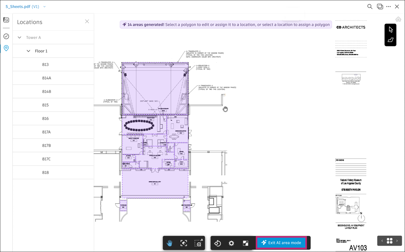

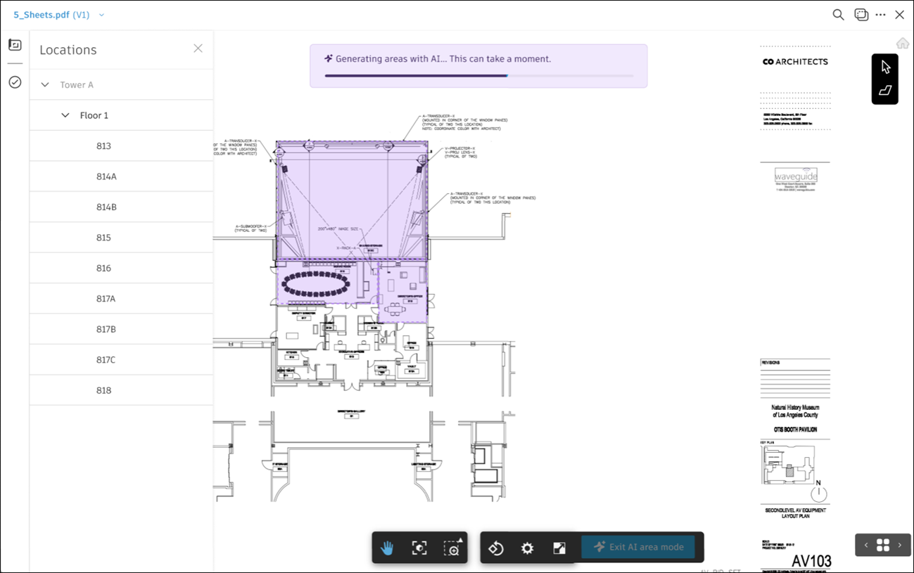

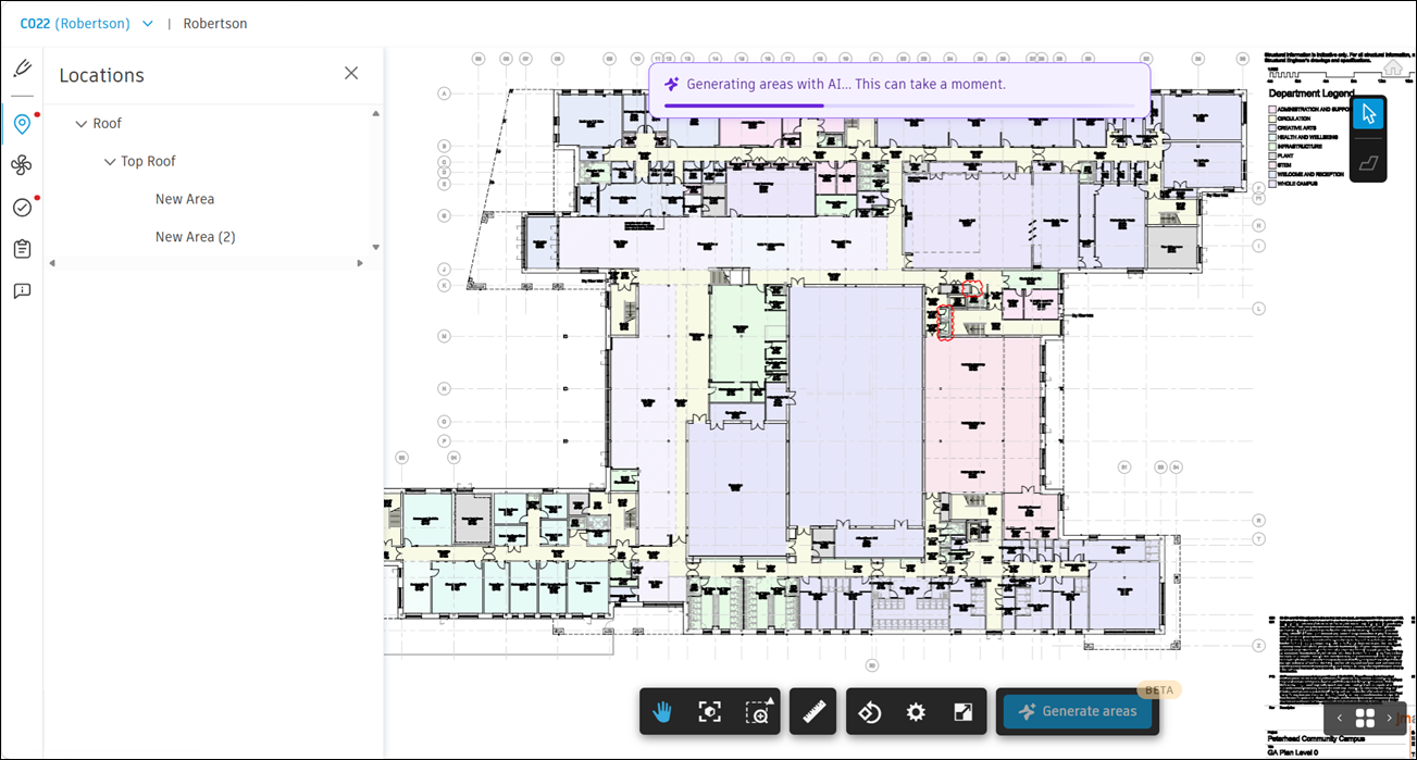

Click Generate areas to enter AI area mode.
Area generation starts and can take a moment to finish.

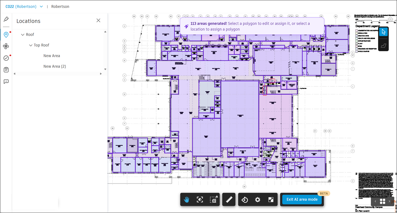

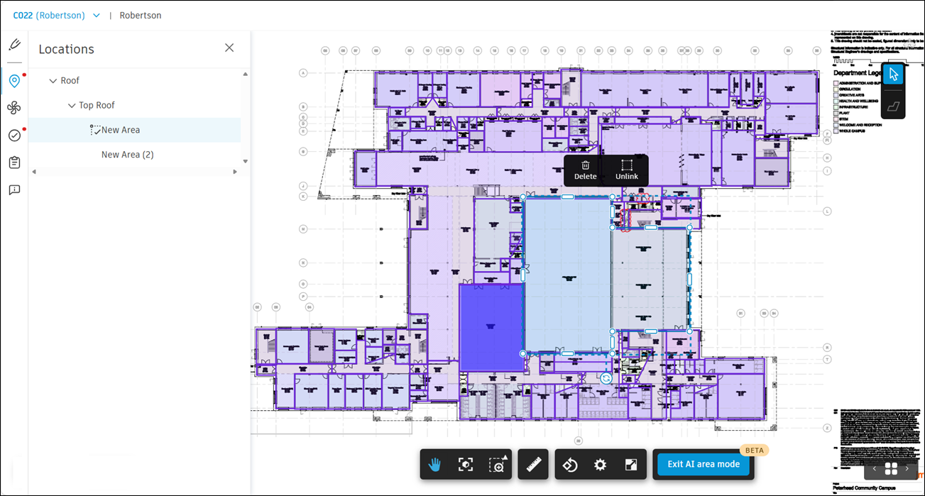

Once polygons are generated, you can select a polygon to edit and link it to a location, or select a location to link a polygon to it.
Note the following detection-specific considerations:
When detection finishes, review the results. The sheet shows how many areas were detected - for example, 12 areas detected.
Detected polygons are temporary, user-specific, and appear only in AI mode. Only you can see the polygons from your detection run - other project members don't see them until you link them to locations. They remain visually distinct from location areas you've already linked. Any location areas you linked earlier remain unchanged and are used as context to improve detection.

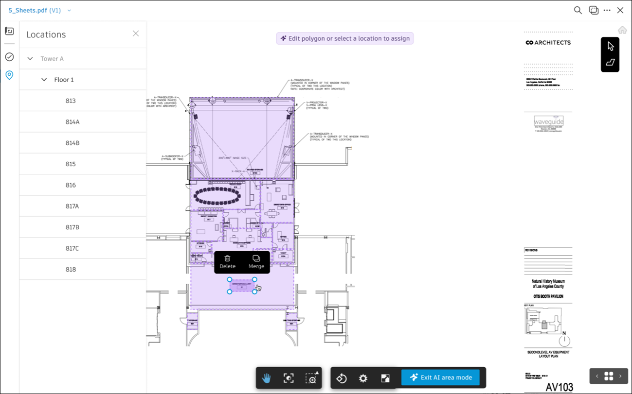

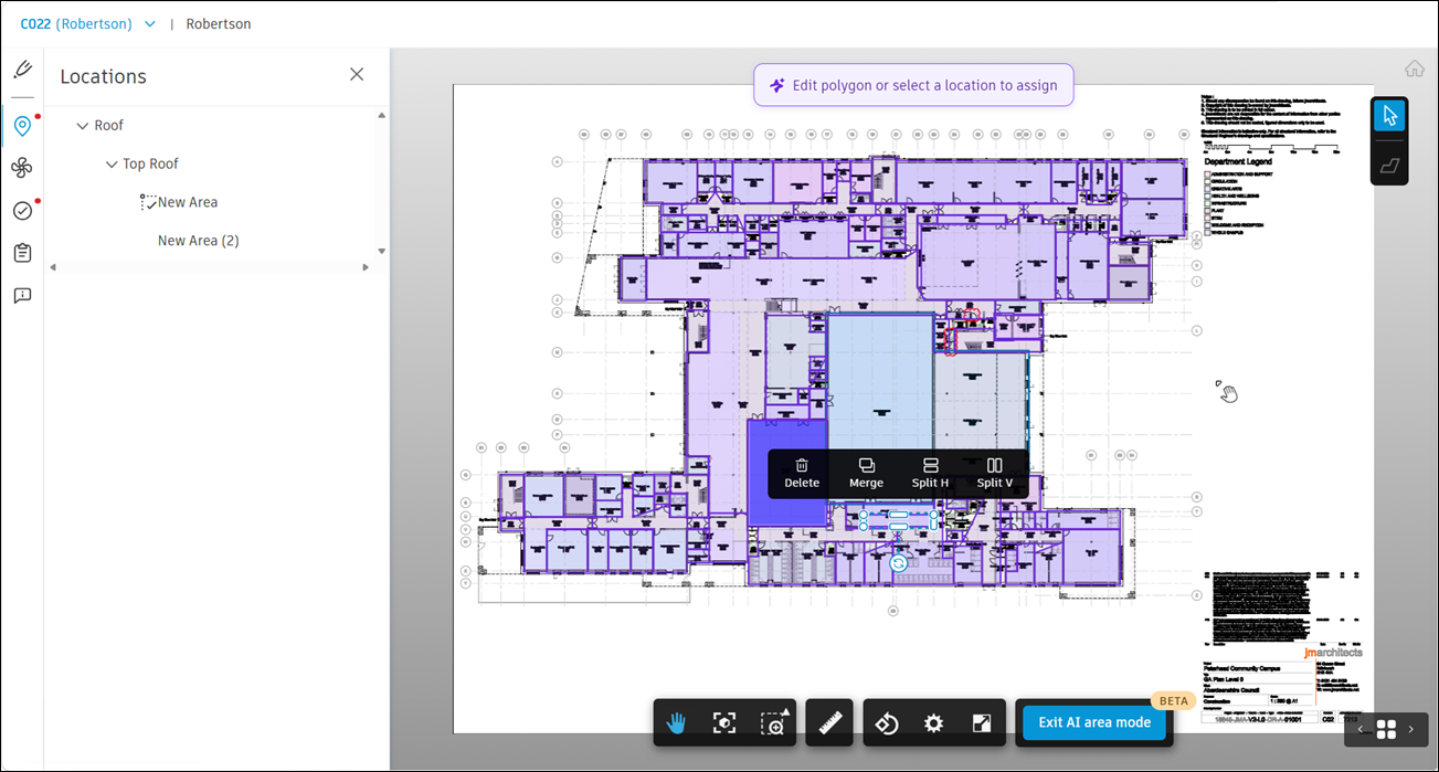

You can refine the suggested polygons before you link them. Select a polygon to open the edit, link, and delete actions. To select more than one polygon, hold Cmd, Ctrl, or Shift as you click.
You can:
Move, add, or remove vertices to adjust a polygon's shape, just like you do in Markups.
Resize or rotate a polygon.
Merge two adjacent polygons into one.
Draw a new polygon if detection missed a room.
Select a polygon, then select Merge.
When the banner appears, select an adjacent polygon - one that shares a border with the first.
The two polygons combine into one, which remains selected.
To merge several polygons at once, select them all first. If they're all adjacent, select Merge.

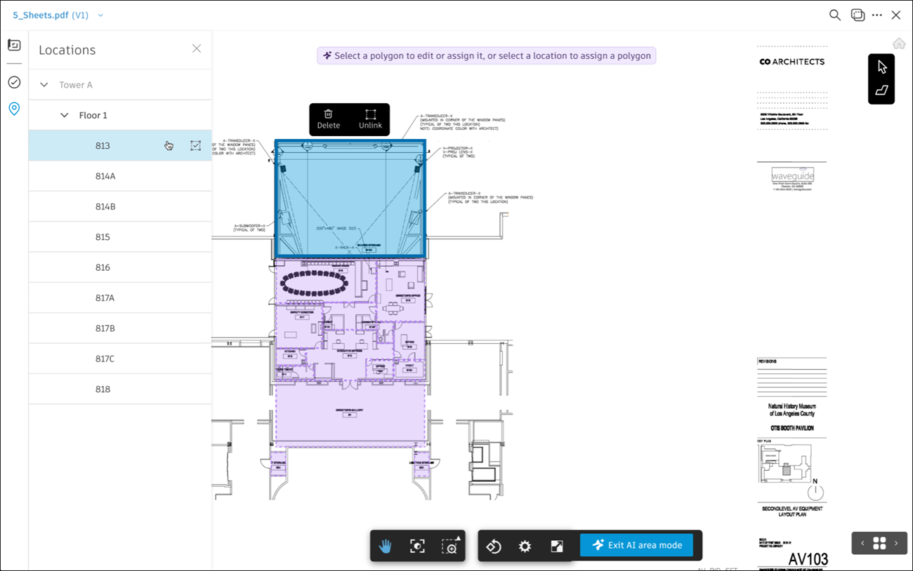

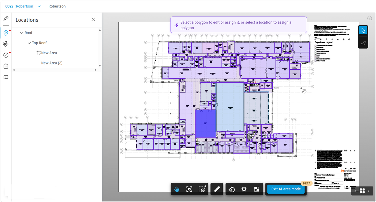

Linking a polygon to a location in your LBS turns it into a location area.
Select a single polygon.
Link it to an LBS node or select an LBS node and link a polygon to it. Both directions work.
Note the following:
You can link only one polygon to one location at a time. You can't link while more than one polygon is selected.
Once linked, a location area looks and behaves the same as any location area you drew manually, whether you're in AI mode or not.

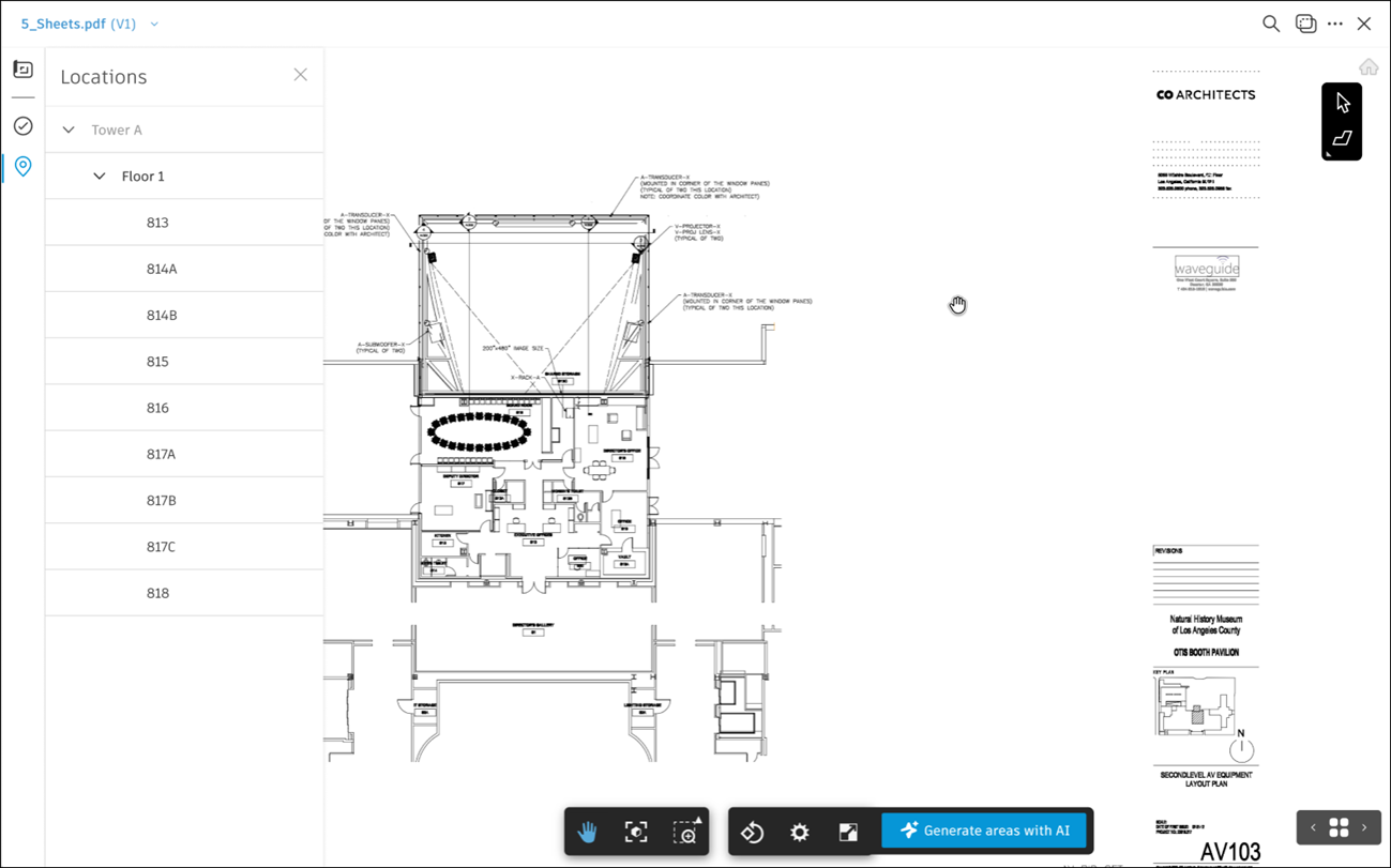

There's no regenerate option. To get a new set of results, delete the current polygons, then run detection again.
Your location areas don't change and are used as context to improve the new results.

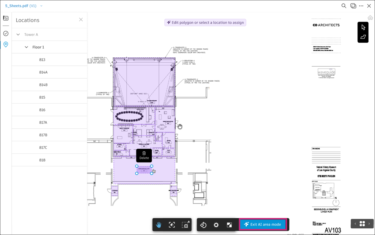

To remove polygons, select one or more, then click Delete to delete them.
To delete a polygon, confirm when prompted. Deleting a location area removes the area and its link to the location, and it can't be undone.
To fix linking without redrawing the location area:
The polygon remains on the sheet but is no longer tied to a location.
To exit AI mode, click Exit AI area mode at the bottom of the screen.
When you exit AI mode, only location areas show on the sheet. Polygons are saved and hidden until you return.
When you re-enter AI mode, your latest results are restored, so you can pick up where you left off.
