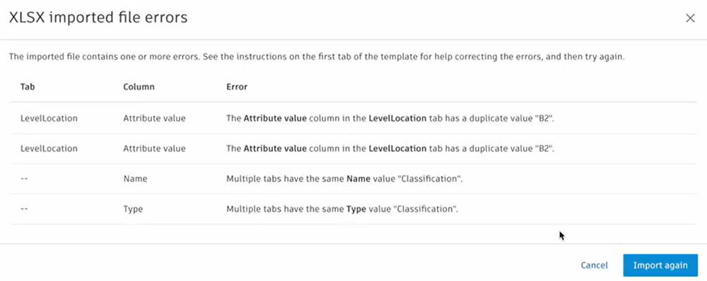

Resolve Imported Template Format Errors
When you attempt to import naming standard, we'll check if the template adheres to the required format. If not, a table specifies each error and provides guidance on how to resolve them before attempting the import again.
  1. Work through each error in the table and edit your Excel naming standard accordingly.
  2. Save the file when you have revised the naming standard by resolving all the errors.
  3. Import the file again.
    Note: You can edit the naming standard once it's imported.
