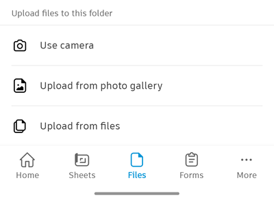

  3. Tap the blue button
    You can choose from the following options:
    Use camera
    You can take one or more videos and photos using the camera on your device and upload all, or a selection, to the relevant folder.
    1. Tap Use camera.
    2. Allow Autodesk Forma permission to take pictures and record video.
    3. Select Video or Camera
    4. Take videos and photos as required.
    5. Tap Done
    6. Tap Upload to upload all videos and photos you've taken. Tap Edit to edit your selection.
    Upload from photo gallery
    This option opens the photo gallery on your device.
    1. Select the desired photos and videos.
    2. Tap Add
    Upload from files
    You can upload files in supported file formats which are stored on your device to project folders in the Files tool.
    1. Tap Upload from files.
    2. Select the relevant files.
    3. Tap Select or the relevant action on your device to start uploading the files.

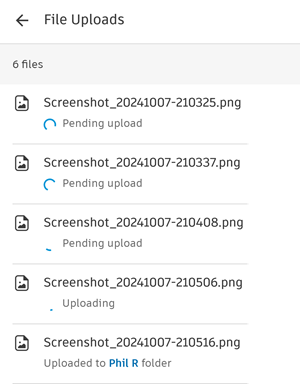

File Uploads List
The progress of your uploads will display in File Uploads:
File Uploads shows the status of files that you're uploading. You can close File uploads and files will continue to process in the background.
File upload status Summary
Uploaded to [folder name] folder The upload is successful. Tap the folder name to open the folder.
Uploading The file is currently uploading
Pending upload The file is queued for uploading.
Uploading error There is a general error. Tap Retry to try again.
Uploading error: File is locked by another member The file is locked and needs to be unlocked before it can be uploaded.
Uploading error: File name is invalid File names can’t contain these characters < > : " / \ | ? * or exceed 255 characters or end with a point. Rename the file locally and try again.
Uploading error: No permission to upload to this folder You don't have permission to upload to this folder. Your permission may have been removed during the upload workflow. Contact your administrator.
Uploading error: File has the same name as a subfolder The file can't have the same name as a subfolder in the target folder. Rename the file locally and try again.
Uploading error: Folder doesn't exist The folder may have been deleted after you selected it and before or during the file upload. Tap Retry or upload the file again to a different folder.
Uploading error: File doesn't conform to naming standard The file doesn't comply with the naming standard and the project doesn't have the holding area turned on. Rename the file locally to comply with the naming standard and try again.
Viewable in holding area on web The file doesn't comply with the naming standard and the project has the holding area turned on. You can access the holding area on web and rename the file correctly to display in the relevant folder.
