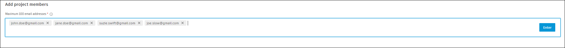

  3. Enter an email address for the members or paste in a list of email addresses separated by commas, tabs, spaces, or semicolons.
    Email addresses
  4. Click Enter to add the members to the member table.
    Member table

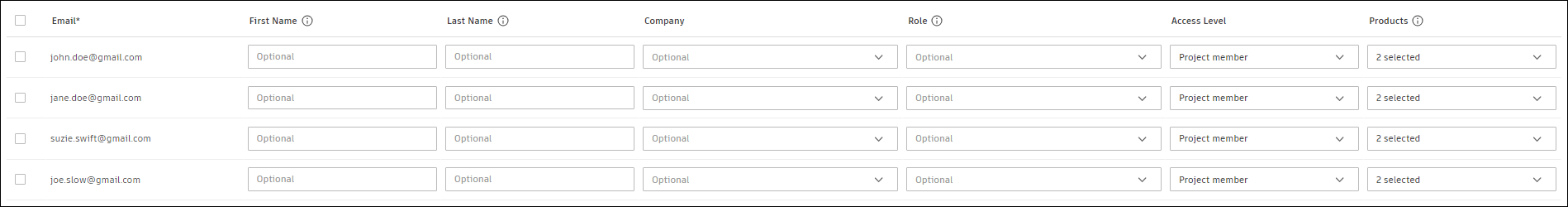

  5. Optionally, if name fields are empty, you can enter the member's first and last name. These will be suggested when they are creating their profile.
  6. Select a Company and Role for each member. The company and role can be used to quickly apply permissions to members.
    Note: Roles update the access level selection. You can manually change the access level after selecting a role.
  7. Choose the access level for the members.

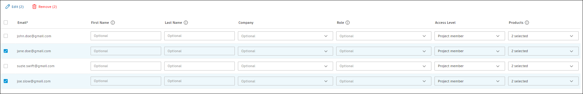

  1. Select the members you want to make changes to.
    Bulk selections

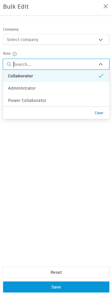

  2. Click Edit. A panel appears on the right.
  3. Use the drop-down lists in the panel to make changes to the members' company, role, access level, and product access.
  4. Click Save.

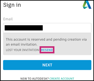

  • Administrators can resend the invitation from the More menu .
  • Members can request to Resend the invitation while signing in.
