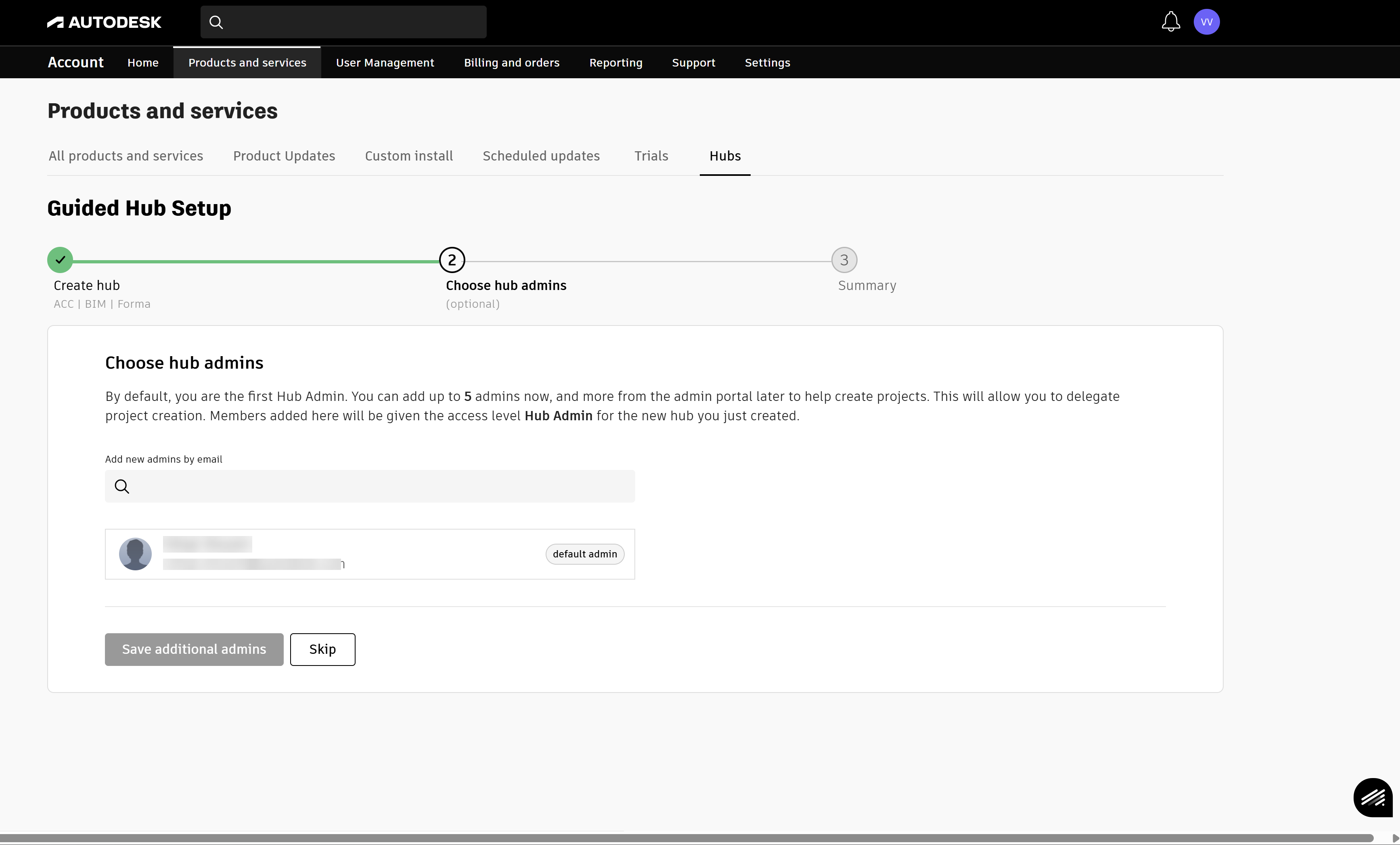

Create Hub Setup Experience Step One
  1. Add more administrators to the hub. Allow others to manage the projects and members in the hub. You can add administrators now or skip this step and add them later from Hub Administration.
Create Hub Setup Experience Step Two

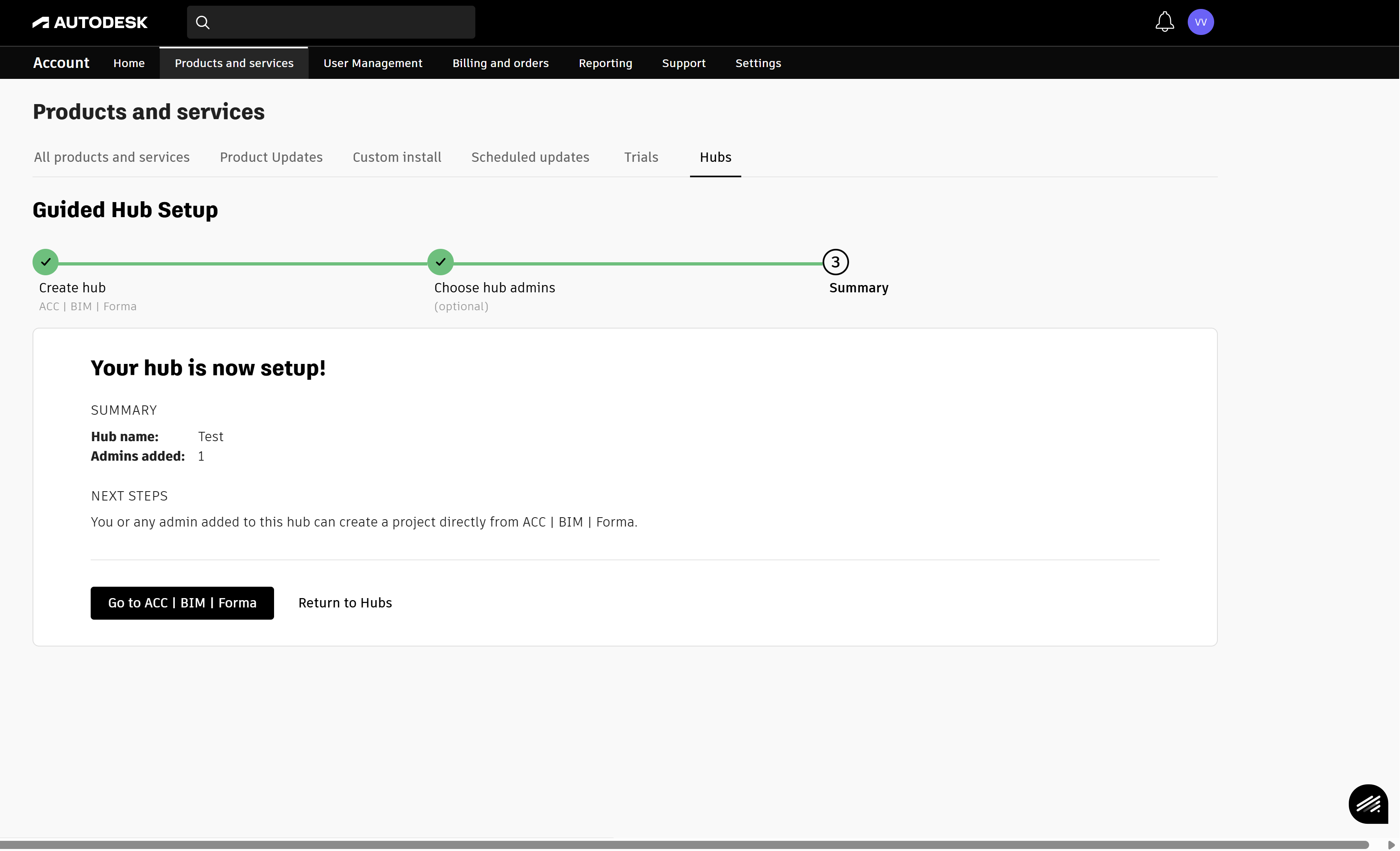

  1. Review the hub details. Then select Go to ACC | BIM | Forma to create projects and manage your hub or Return to Hubs to view your list of hubs.
Create Hub Setup Experience Step Three
