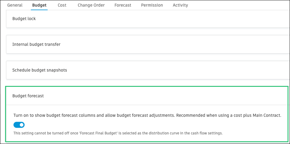

New setting to turn on new columns (can also be turned on manually in column visibility settings). To learn more, see Budget Forecast.

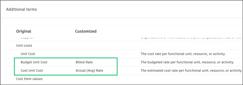

The terminology of new columns is customizable in the Settings tool. Choose the General tab and scroll down to Additional terms. This naming is also used in date range forecast settings.

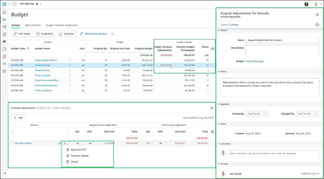

You can now add budget and/or cost forecast adjustments with a new bottom flyout for viewing and processing. See Create Forecast Adjustments to learn more.
You can now generate a Potential Change Order (PCO) or Budget Transfer directly from a forecast adjustment. The adjustment is retained but the qty is reset to zero to avoid double counting, and all activity is logged in the new forecast adjustment flyout for audit tracking.
The new side forecast adjustment flyout also contains a new notes field for documenting reasons for adjustments.

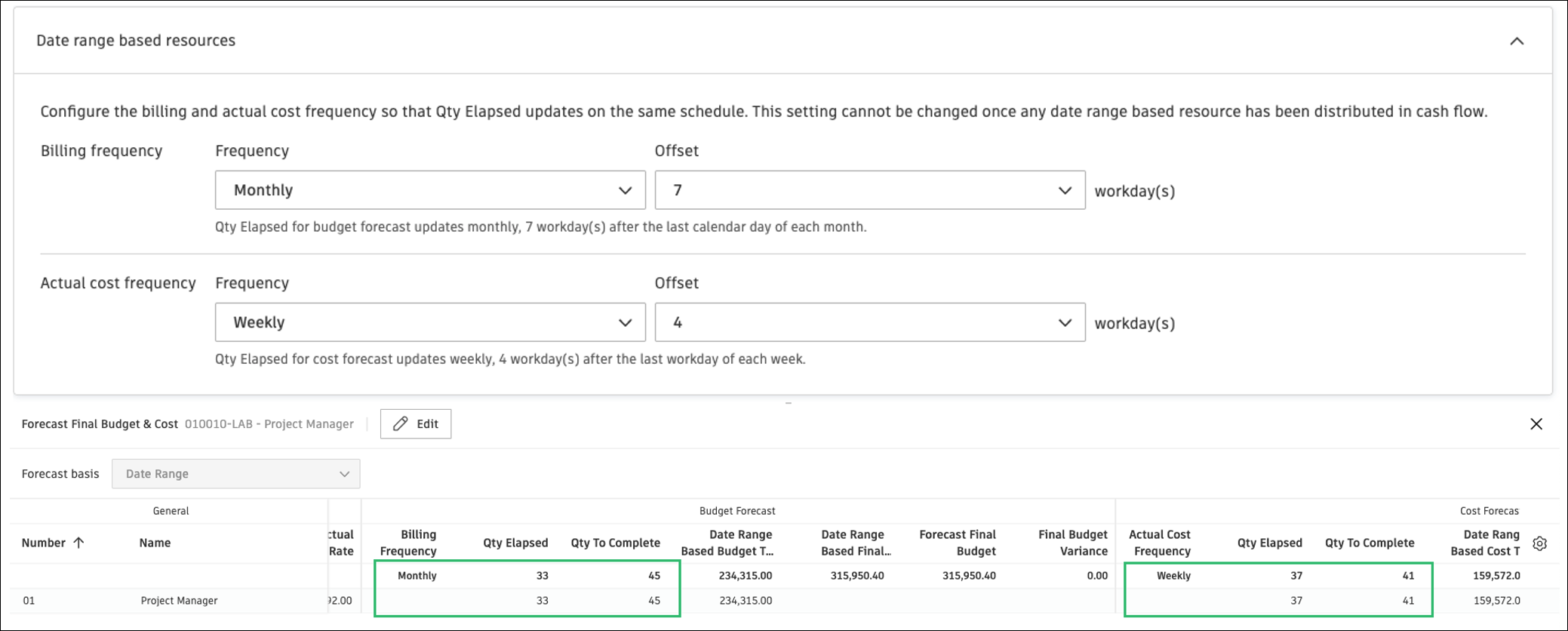

Billing & Actual Cost Frequency – A new setting in the Budget section of Cost Management Settings allows project administrators to configure the billing and actual cost frequency and set so that Qty Elapsed updates on the same schedule. See Date Range Based Resources and Date Range Based Forecasting to learn more.
Administrators can also define an offset to apply to account for the time it takes for the actual cost data to be collated and integrated from the ERP.
This setting cannot be changed once any date range-based resource has been distributed in cash flow.
