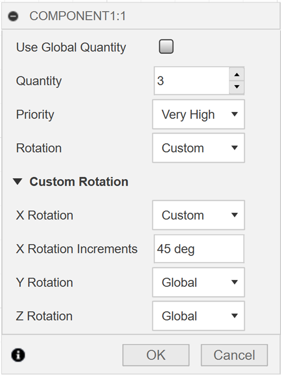

CAMArrangeParameterValue
The CAMArrangeParameterValue type of parameter value is returned for the arrangeTargets parameter of an additive arrange operation.
The value property returns an ArrangeSelections object, which is a collection of objects that represent an ArrangeSelection.
When editing a component in the user interface, you can define the options shown below in the edit component dialog. These same options are available in the API on the ArrangeSelection object.
CamArrangeSelection
Available properties on the ArrangeSelection object:
If the isUsingCustom property of an ArrangeSelection is false, the accompanying global option of the arrange operation will be used.
The code below has the user select an occurrence and then adds that occurrence as an arrange selection to an existing arrange operation.
#Author-
#Description-
import adsk.core, adsk.fusion, adsk.cam, traceback
def addArrangeSelection():
    try:
        app = adsk.core.Application.get()
        ui = app.userInterface
        cam: adsk.cam.CAM = app.activeProduct
        # Have a component selected to use for the arrangement.
        sel = ui.selectEntity('Select a component to arrange.', 'Occurrences')
        component: adsk.fusion.Occurrence = sel.entity
        # Get an operation that has a specific name from the first setup.
        setup = cam.setups[0]
        op = setup.operations.itemByName('Additive Arrange')
        # Get the "arrangeTargets" parameter from the operation, which is a CAMArrangeParameterValue.
        arrangeParam: adsk.cam.CAMArrangeParameterValue = op.parameters.itemByName('arrangeTargets').value
        # Get the ArrangeSelections object from the CAMArrangeParameterValue. This
        # object manages the list of arrange selections.
        arrangeSelections: adsk.cam.ArrangeSelections = arrangeParam.getArrangeSelections()
        # Create a new arrange selection.
        arrangeSel: adsk.cam.ArrangeSelection = arrangeSelections.createNewArrangeSelection()
        # Set some properties of the arrange selection.
        arrangeSel.priorityType = adsk.cam.ArrangePriorityTypes.VeryHighArrangePriorityType
        arrangeSel.customRotationX = 45
        arrangeSel.customQuantity = 2
        # Add the component to the arrange selection.
        arrangeSel.inputGeometry = component
        # Apply the arrange selection back to the parameter.
        arrangeParam.applyArrangeSelections(arrangeSelections)
    except:
        if ui:
            ui.messageBox('Failed:\n{}'.format(traceback.format_exc()))
def run(context):
    ui = None
    try:
        cam.generateToolpath(op)
    except:
        if ui:
