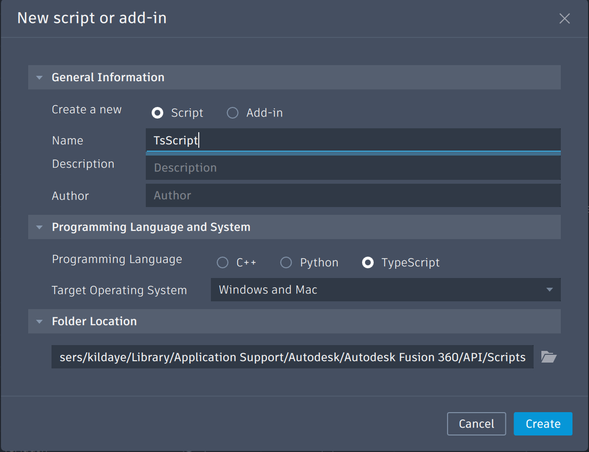

Creating Scripts and Add-Ins with TypeScript
To create a new TypeScript script or add-in you use the "Create" button in the Scripts and Add-Ins dialog to display the New Script or Add-In dialog and choose "TypeScript" as the programming language.
Scripts command
Creating a new TypeScript script will create a working script that you can immediately run. It provides a framework that you can edit to add the functionality your script requires.

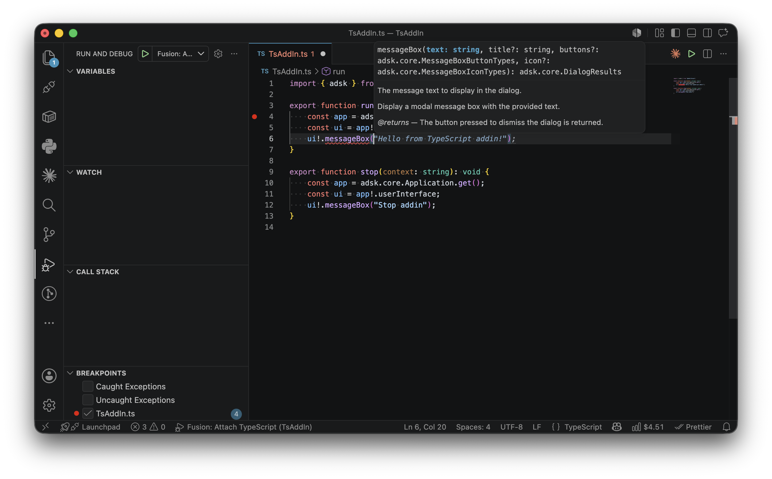

Editing and Debugging a TypeScript Script or Add-In
VS Code is the recommended IDE for editing and debugging TypeScript scripts and add-ins. To open a script directly from Fusion, run the Scripts and Add-Ins command, select the script or add-in, and click the "Edit" button.
Because TypeScript is statically typed, VS Code provides rich code completion, inline error checking, and refactoring support out of the box. The API type definition files (.d.ts) included with the script template give you full IntelliSense coverage for the entire Fusion API.
Scripts command
When you run a script, TypeScript files are transpiled to JavaScript before execution. Plain .js files skip transpilation and are executed directly, so you can also use the API from JavaScript without the TypeScript compiler.
To debug a script locally, use the debug launch configuration in VS Code. Note that you must first edit the script from Fusion before debugging it. This starts the debug server and updates the VS Code workspace configuration so that the debugger can attach correctly.
