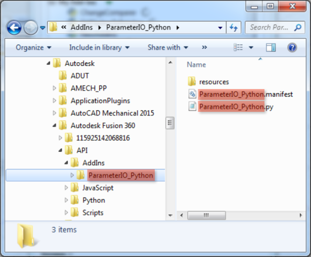

Inside the existing Scripts or AddIns folder you need to create a new folder whose name is the name as the .manifest file that will exist for each sample.
For example, in the case of the ParameterIO_Python sample, which is an Add-In, the manifest file is named ParameterIO_Python.manifest, therefore you should create a new ParameterIO_Python folder under the appropriate Fusion folder:

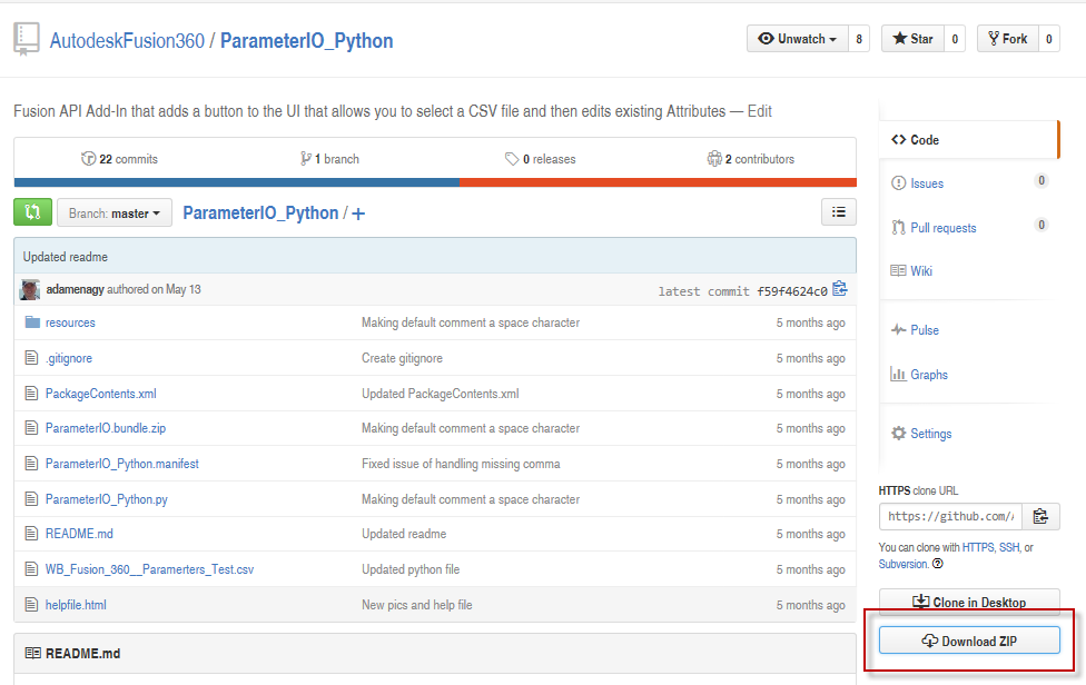

You now need to copy all of the files of the script or add-in to this new folder. The easiest way to do that is to use the Download Zip option in GitHub, as shown below. This will package all of the files into a single zip and download it to your computer. You can then unpack the zip, maintaining any subdirectories, into the new directory you created. There will be a few extra GitHub specific files but they won't hurt anything and you can choose to delete them or not.

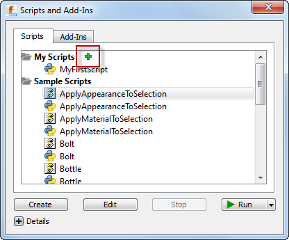

Once you restart Fusion, the Add-In or Script will be ready to use and shows up in the Scripts and Add-Ins dialog, as shown below.
To be able to put the sample at any location on your machine, create a new folder anywhere on your machine, using the same name as the .manifest file. Using the Download Zip GitHub option as described above, copy all of the samples, files into the newly created folder. To make the script or add-in known to Fusion, run the Script and Add-Ins command and click the green "+" icon beside the "My Scripts" or "My Add-Ins" folder in the dialog, as shown below. Use the dialog to browse to the location of the script or add-in and choose the .py, .js, .dll (for Windows), or .pylib (for Mac) file. The script or add-in will now be listed in the Scripts and Add-Ins dialog and you can run, edit, and debug it from there the same as any other script or add-in. You only need to do this once and Fusion will remember the script or add-in for all subsequent sessions.
