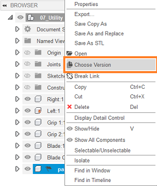

In the browser, identify the linked design that you want to choose a different milestone for.
Right-click the design.
Click
Choose Version from the menu.

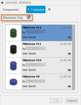

Choose Version dialog displays.
Check the Milestones Only check box to see milestones only.
Choose the desired milestone.
Click OK.
