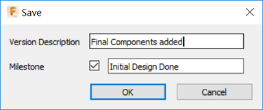

  1. Click Save save icon.
  2. In the save dialog, check the Milestone check box.
    save
  3. Enter a version description and milestone name. Changing the description and milestone name are optional but recommended.
  4. Click OK.

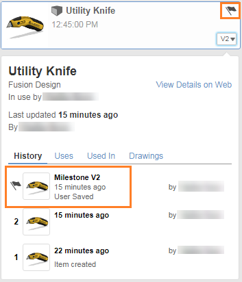

Notice the milestone icon appears in the Data Panel in the upper right corner of the design’s thumbnail and in the version view list.
milestones data panel

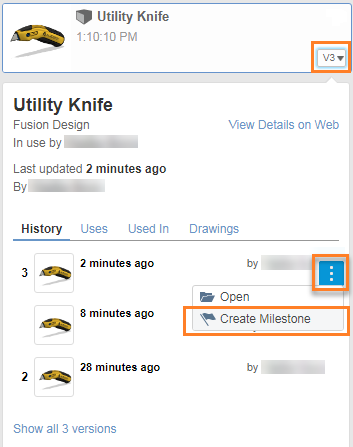

Create milestones using the Data Panel – design’s version drop-down
Milestones can be also created inside the Data Panel. This is especially helpful when you'd like to make a version of the design a milestone later on.
  1. In the Data Panel, click the version drop-down in the lower right corner of the design’s thumbnail.
  2. Hover over the version you want to milestone and click vertical more icon More.
  3. Click milestone flag Create Milestone.
    create milestone
  4. Enter a version description and milestone name. Changing the description and milestone name are optional but recommended.
  5. Click Create Milestone.

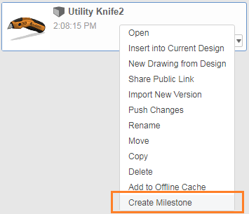

Create milestones using the Data Panel – design’s right-click menu
  1. In the Data Panel, right-click the design’s thumbnail.
  2. Click milestone flag Create Milestone.
    create milestone
  4. Click Create Milestone.

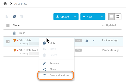

Create milestones by highlighting the design
  1. Navigate to the project containing the file that requires a milestone.
  2. Place the pointer over the line containing the design.

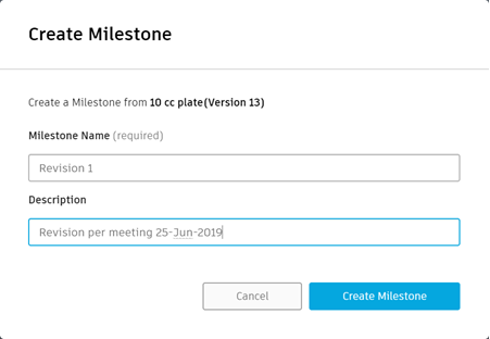

  3. Right-click and select milestone flag Create Milestone.
    web client create milestone
    web client create milestone button

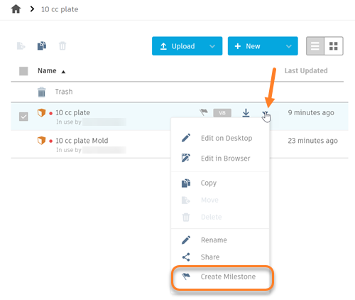

Create milestones from the design pull-down list
  2. Click on the pull-down list for the file that requires a milestone and select milestone flag Create Milestone.
    web client milestones list

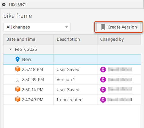

Create a version from the History dialog
  1. With a design open, right-click a component in the Browser.
  2. In the context menu that opens, click History.
  3. In the History dialog that opens, click Create version.

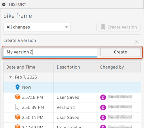

    history dialog
  4. Enter a name for the version and click Create.

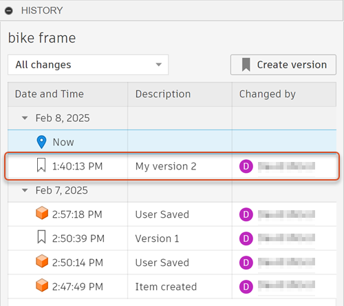

    history dialog
    The version is added to the table with the new version icon history dialog.
    history dialog

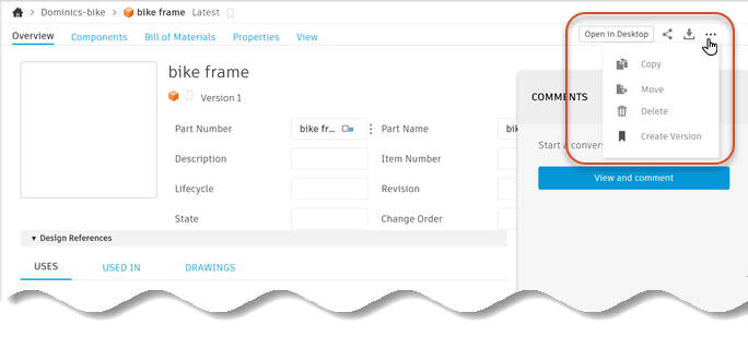

Create a version in the Fusion web client
  1. Navigate to a design or component in the Fusion web client.
  2. At the top right of the window, click ....
    create version
  3. Select Create Version.
  4. In the Create Version dialog that opens, enter a description for the version.
  5. Click Create Version.
