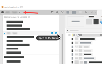

  1. In Fusion, expand the list of teams at the top of the Data Panel.
  2. Click Open in the Web.
    Open the Fusion web client
    the Fusion web client opens the project page in a web browser.

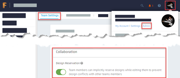

  3. In the Fusion web client, in the top-right corner, click your profile picture or initials, then click Admin.
  4. On the Team Settings tab, scroll to the Collaboration section.
  5. Under Design Reservation, click the toggle toggle on icon so that it appears green.
Design Reservation is enabled for the team. Project members reserve designs to prevent design conflicts.

  1. Repeat steps 1-4 above.
  2. Under Design Reservation, click the toggle toggle on icon so that it appears grey.
Design Reservation is disabled for the team. Project members cannot reserve designs. Any current reservations are removed.
