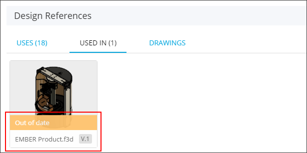

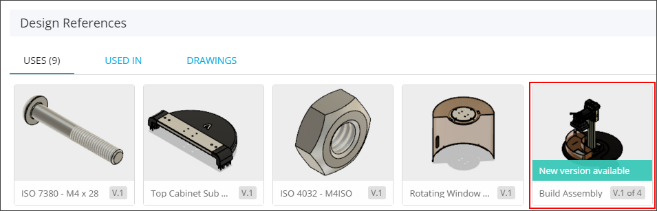

The Design References section shows relationships between designs and assemblies in Fusion. These relationships include:
In Fusion for education, if a design reference gets updated, both the parent and child design will be marked with the following:

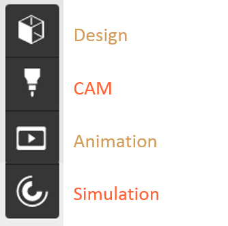

In the top-left corner of the Viewer, you can switch between different types of related data (if available).
viewer related data

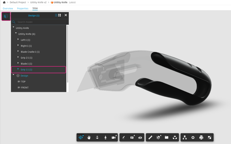

You can view, select, and isolate parts in a design using one of the following methods:
viewer select part fusion design
This image above shows a selected part within a design. Right-click on the part to access additional options:

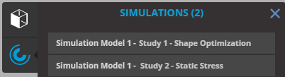

  1. Click the Simulation icon in the top-left corner of the Viewer to open the Browser.
  2. Select a study to view its results.
  3. Expand the study in the Browser to see the applied constraints and loads.

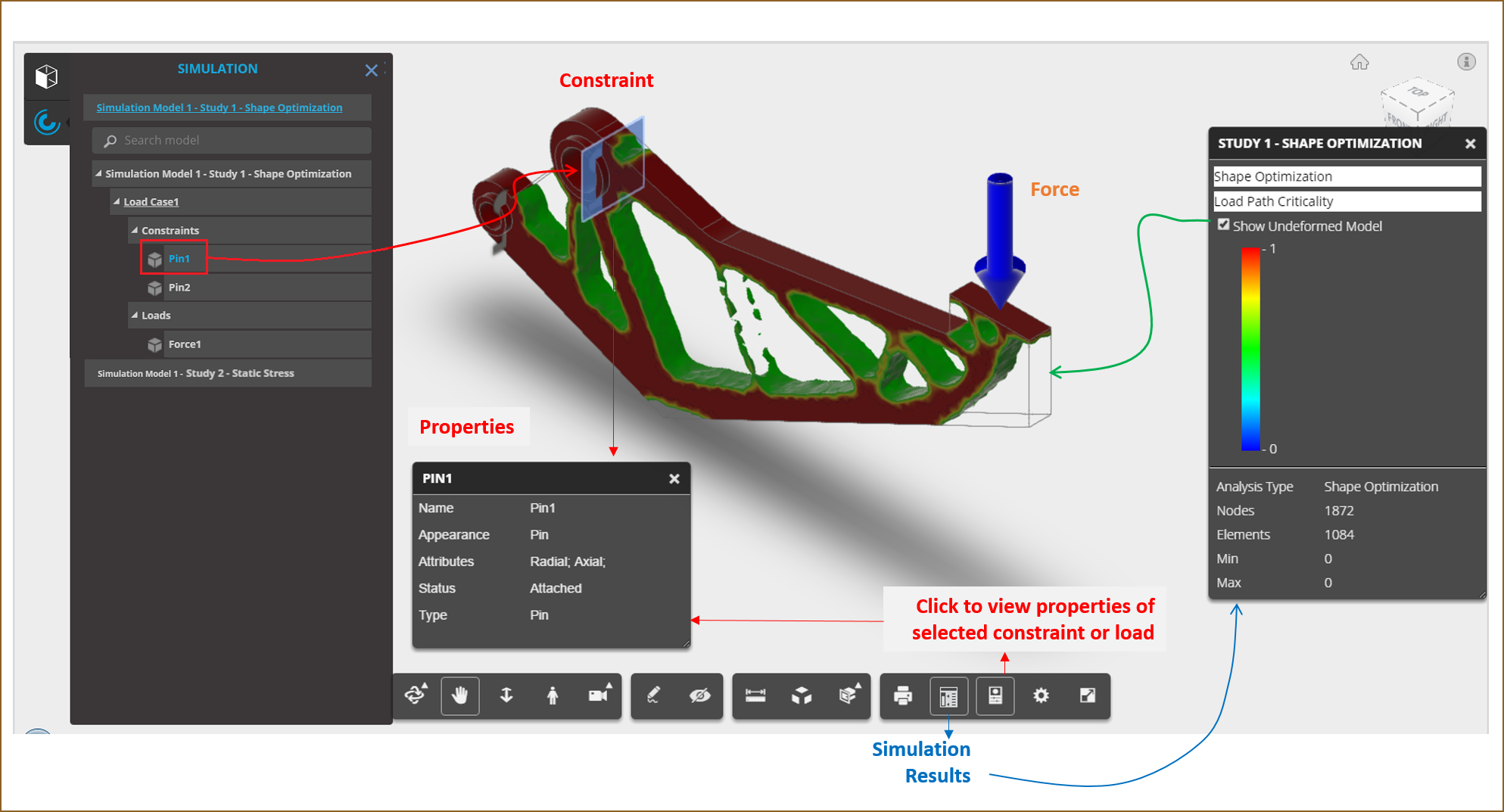

    view simulation study in viewer
  4. Select a load or constraint and click the Properties button in the Viewer toolbar to view its properties.
    view simulation results in viewer
    Note: Properties are not available if you're working in a hub with collaborative editing. Check for this icon collaborative editing next to the hub name to confirm collaborative editing is available.

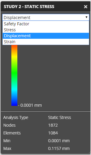

  5. Select Show Undeformed model in the Simulation Results pane to view the outline of the original model.
  6. For studies that produce multiple result types, select the result contour plot that you want to view.
    filter simulation results in viewer
Note: The Simulations Results window opens in the Viewer.

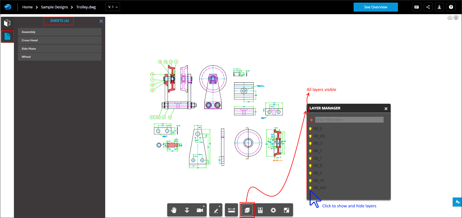

Inside a DWG File
view DWG file in viewer
