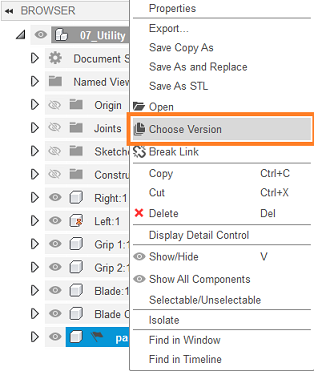

  1. In the browser, identify the linked design that you want to choose a different milestone for.
  2. Right-click the design.
  3. Click history icon Choose Version from the menu.
    milestones choose version

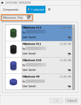

    Choose Version dialog displays.
  4. Check the Milestones Only check box to see milestones only.
  5. Choose the desired milestone.
  6. Click OK.
chose version dialog
