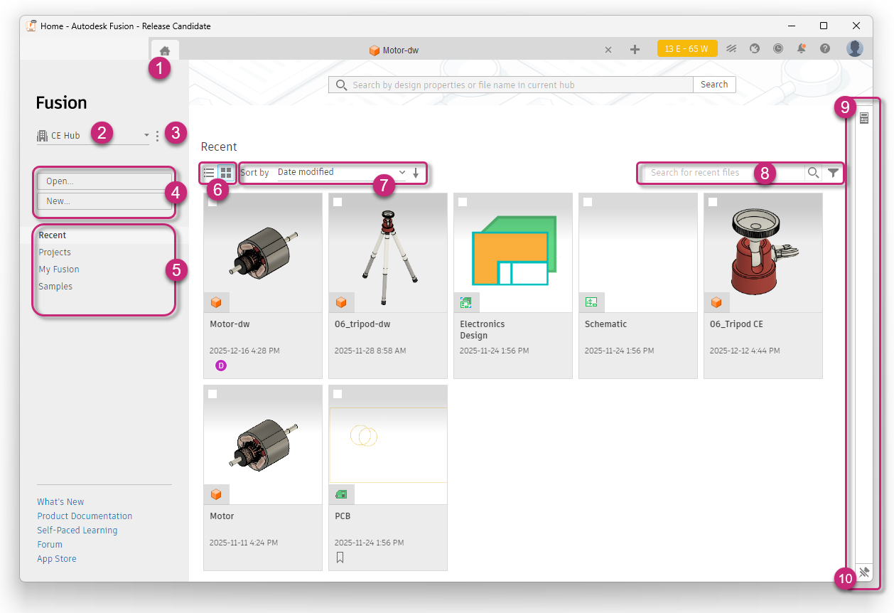

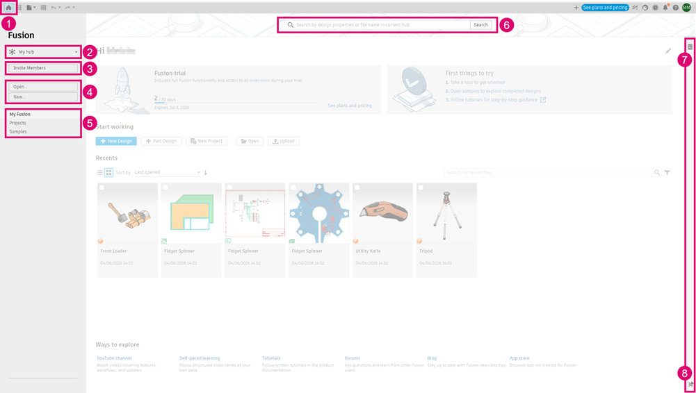

The overview below introduces navigation and other controls you use in Home. My Fusion is shown in the main area as an example; each page is described in the sections that follow.
Home overview
  1. Home Home icon — Open Home from any workspace.
  2. Hub switcher — Work in the hub that holds your projects and data. Switch hubs when you collaborate with more than one team.
  3. Invite Members — Add people to the hub (hub admins only).
  4. Open and New — Create a design or open an existing one.
  5. My Fusion, Projects, and Samples — Open the page you need: start work and find recent files (My Fusion), browse and manage projects and folders in your hub (Projects), or explore example designs (Samples).
  6. Search — Find designs, files, and properties in the current hub. (Not available in Fusion for education.)
  7. Details properties icon — Open the Details panel for the selected file or folder.
  8. Pin pin icon — Pin the Details panel so it stays open while you work in Home.

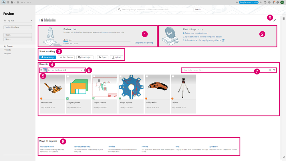

My Fusion is the first page in Home and brings together shortcuts to start work, your recent files, onboarding guidance for new users, and links to learning resources.
My Fusion page in Home
  1. Access information — See information about your Fusion access and whether any action may be required. Depending on the type of Fusion access you have, this may include trial status, expiration details, or renewal-related actions.
    Note: This section is shown only for eligible users.
  2. First things to try — See onboarding guidance designed to help you get started. This includes:
    • Taking a tour
    • Exploring sample designs
    • Following guided learning
      Note: This section is shown during the onboarding period for eligible users. After onboarding, the space may be used to surface other relevant information, such as recent product updates.
  3. Start working — Quickly create a design, create a project, open a file, or upload data.
    The second action is a shortcut that launches your default design type, which may be part design, assembly design, hybrid design, electronics design, or electronics library. See Edit (9) to change the default design type.
  4. Recents — Access files you've recently worked on.
  5. List View and Grid View — Switch between List View list icon and Grid View grid icon.
    Note: In List View, you can customize columns using Column Settings column settings icon.
  6. Sort by — Change the order of files in the Recents list.
  7. Search for recent files — Use Search for recent files search icon and Filter filter icon to find and narrow the Recents list.
  8. Ways to explore — Explore video-based learning content, product documentation, community resources on the forums, blogs, and the Design and Make Marketplace.
  9. Edit edit icon — Update your purpose for using Fusion and basic preferences. Choose a purpose such as design, manufacturing, or electronics, or a combination.
    Purpose influences the First things to try section. You can also set default design type, units, and mouse setup. Default design type determines the second shortcut in Start working.
Note: The layout and sections on My Fusion may vary depending on the type of Fusion access you have and whether you’re new to Fusion or have been using Fusion for a while.

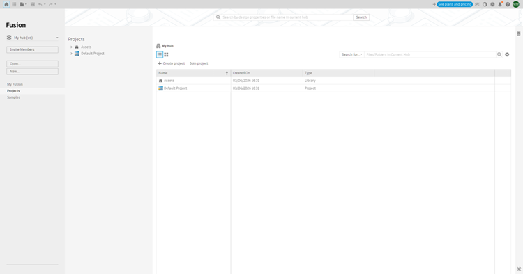

Projects is the second page in Home and lets you browse and manage projects and folders in the current hub. Select a project in the project list to see its folders and files in the main area. Use the Search for drop-down to look for files and folders or projects. Choose whether to search the hub, a project, or a folder.
Projects page in Home
For information about managing projects, see Create, rename, and move project folders to Trash.

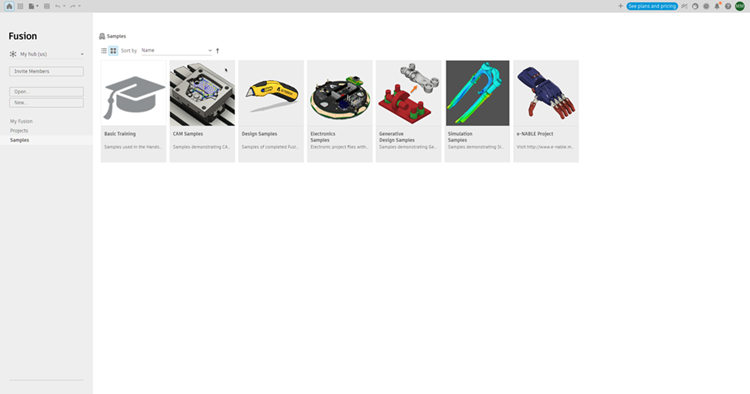

Samples is the third page in Home and provides example designs from Autodesk, grouped by area such as design, manufacture, electronics, and simulation.
Samples page in Home
Some tutorials use sample files.
