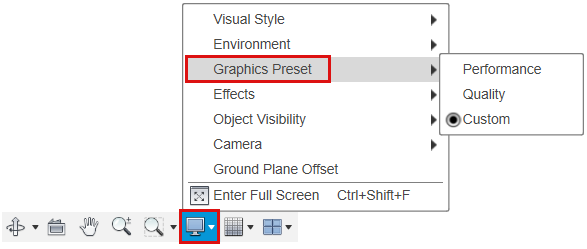

Graphics presets
Select a graphics preset to quickly change the related settings. Changes to Quality or Performance presets will override the Custom preset.
Optimizes graphical performance but may reduce visual quality.
Quality
Provides a better visual experience but may reduce canvas navigation performance.
Custom
These graphics settings can be modified so you can balance quality and performance to meet your specific needs. Canvas Effects can also be modified in the Canvas toolbar. Changes to Canvas Effects overwrite the Custom preset.

Note: You can also access the Graphics Presets from the Display Settings on the Navigation Bar.
