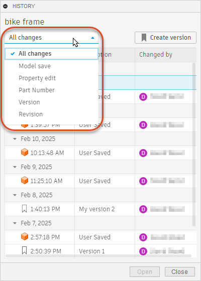

Work with versions and changes in the History dialog
  1. Optional: In the History dialog, select which type of changes you want to see.
    history filter

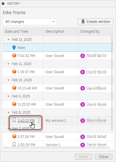

  2. Place the pointer over the time stamp that corresponds to the change or version you want to open.
    history filter
  3. Click the time stamp to go that version or change.
