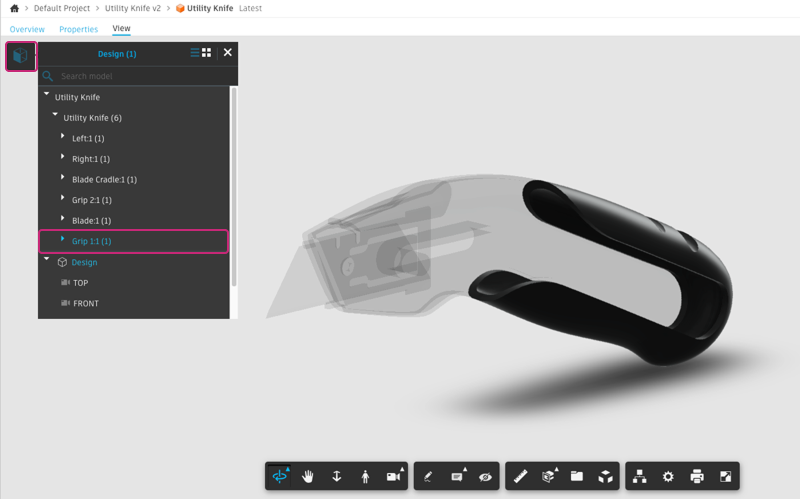

View parts in a design
You can view, select, and isolate parts in a design using one of the following methods:
viewer select part fusion design
This image above shows a selected part within a design. Right-click on the part to access additional options:
