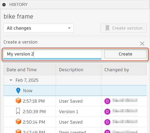

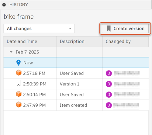

Create a version from the History dialog
  1. With a design open, right-click a component in the Browser.
  2. In the context menu that opens, click History.
  3. In the History dialog that opens, click Create version.
    history dialog

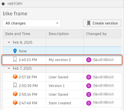

  4. Enter a name for the version and click Create.
    history dialog
    The version is added to the table with the new version icon history dialog.
    history dialog

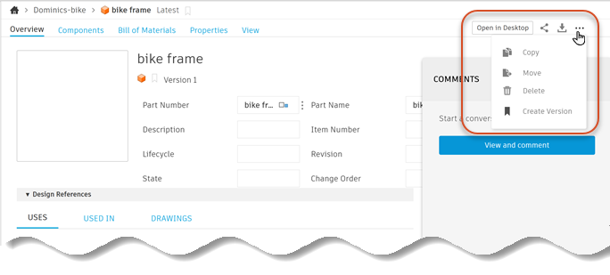

Create a version in the Fusion web client
  1. Navigate to a design or component in the Fusion web client.
  2. At the top right of the window, click ....
    create version
  3. Select Create Version.
  4. In the Create Version dialog that opens, enter a description for the version.
  5. Click Create Version.
