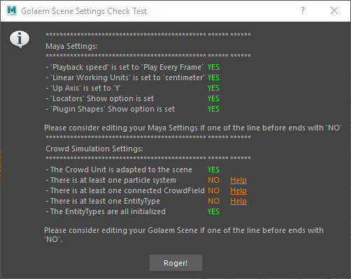

To work properly, Golaem Crowd requires some specific Maya settings (time unit, distance unit…). To check your Maya configuration, run the Golaem Crowd Check Scene Tool using menu Golaem > Check Scene Settings.
You may consider editing your Maya settings if one of the lines of the tool ends with "NO".
Playback Speed
This setting is only needed when simulating crowds with Golaem Crowd, so you can safely ignore it with Golaem Layout.

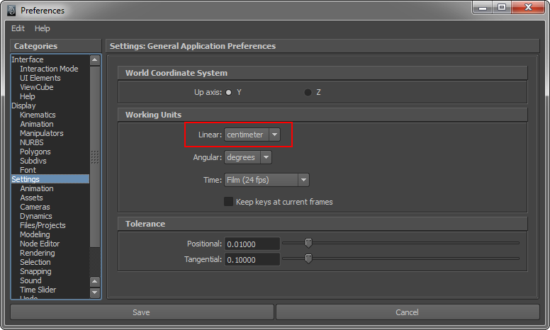

Currently Golaem Crowd only supports the "centimeter" Linear Working Unit (default Maya value). More importantly, by default, Golaem Crowd considers that one Maya Unit equals one meter. This convention can be easily changed if needed (see the Simulation Unit part below).
To change the Linear Working Unit, open the Maya Preferences using menu Window > Settings / Preferences > Preferences then browsing the Settings category:
Up Axis
Currently Golaem Crowd only supports the "y" up axis world coordinate system. To change the Linear Working Unit, open the Maya Preferences using menu Window > Settings / Preferences > Preferences then browsing the Settings category:
