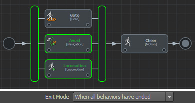

By default the Parallel Operator only exits when all its nested Behaviors have exited. It can be changed in the Parallel Operator attributes:

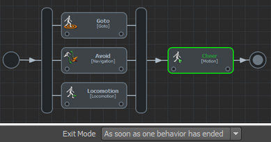

Here is an example of using different exit modes when a Go To Behavior reaches its target:

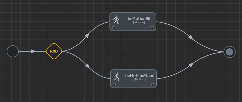

For more control over the ratio of used motions, use the Random Operator

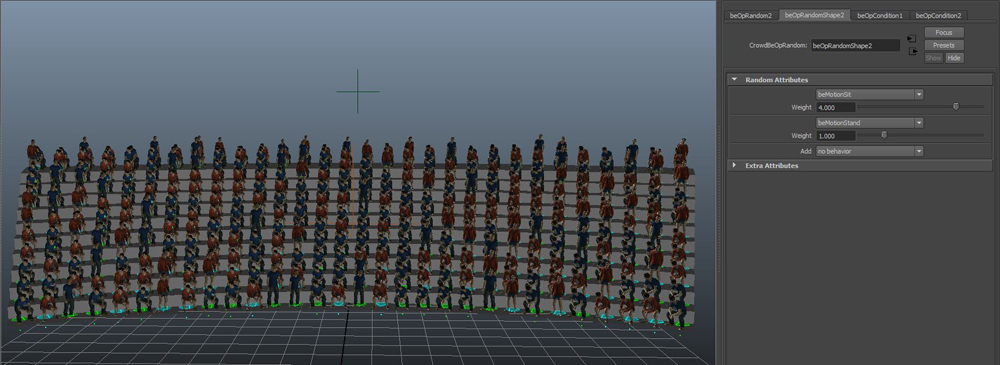

When using a Random Operator to play multiple motions on a single entityType it may be interesting to edit the rate of characters playing a motion instead of another.

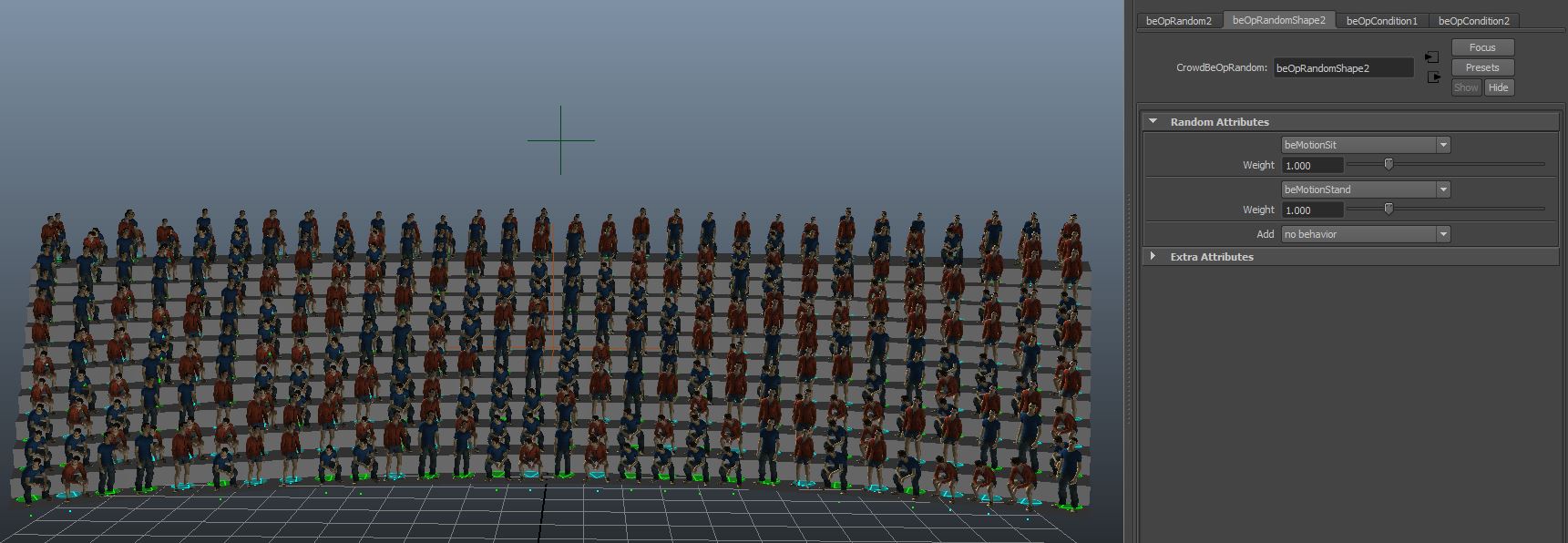

With the default values of 1 and 1 the motions are played 50/50.

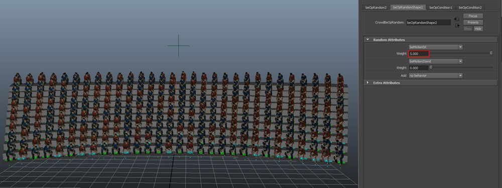

Just go inside the Random Operator attributes and edit the weight of your Behaviors
One motion is played by 100% of the entities.

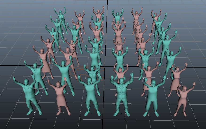

One motion played by 80% of the crowd.
