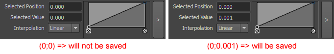

Due to a Maya bug, creating a control point at position 0 with a value of 0 will not be saved within the Maya file. Putting any other position or value different than 0 (even really small) will fix the problem:
