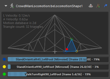

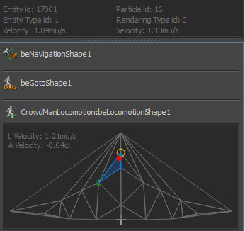

Each of the dot in the visual feedback corresponds to one of the motions in the locomotion set, its coordinates being its angular and linear speeds.

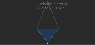

The red dot is the desired linear and angular velocities (the control command), and the triangle in which it stands are the 3 motions that are currently blended together. When the navigation asks for different velocities, the control command will be changed accordingly, and so will the blended animation's weights.
Now when the database has very narrow triangles, it means that any slight change in the control command may bring a wide change in the blending parameters, or even change the currently blended motions ("switching between different motions"), so it's strongly advised to avoid narrow triangles in this database. When narrow triangles are identified, it's useful to also identify the motion files that produce them. This is done by putting the mouse on each point, which should bring a tooltip showing the name of the motion, as well as its angular and linear velocities:

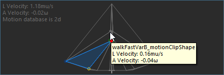

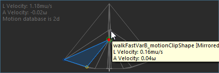

An animation with a very little angular velocity was used together with it's mirror version. That produce a very narrow triangle and should not be done. Only animations with a high enough angular velocity should be used with their mirror version. Check the mirror configuration in the locomotion behavior documentation.

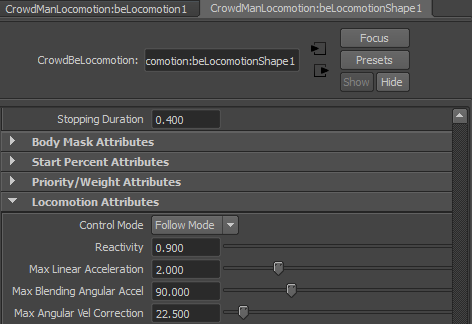

Is acceleration set correctly ?

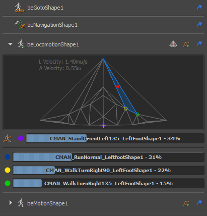

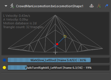

When blending animations together, the weight of each animation changes accordingly with the maximum acceleration allowed. When the acceleration is too high, it might produce pops in the animation due to weights changing too much in one single frame.
To check if this is the case, find out the frame at which a character's animation 'pop', and select it to to display the Visual Feedback Tool. Check what are the weights of the animation at the frame before the pop, and the frame after the pop. If the difference is too big, then the pop comes from either a big linear or angular acceleration.
Example of an acceleration that produces a pop: at one frame, the WalkSlow_Leftfoot animation has a weight of 82%, while it has a weight of 0% at the next frame
To check if the problem is a too bug linear or angular acceleration, look out for the red dot in the locomotion database before and after the "pop":

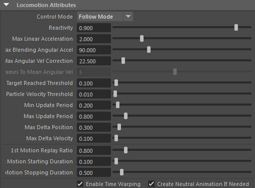

Change the maximum acceleration value in the locomotion parameters:
The parameters to change are the "Max Linear Acceleration" and "Max Blending Angular Accel."

Finally, if only legs are popping but the rest of the body is fine, it might be a Time Warping issue. Try unchecking the option in the Locomotion Attributes to check if it solves the issue.

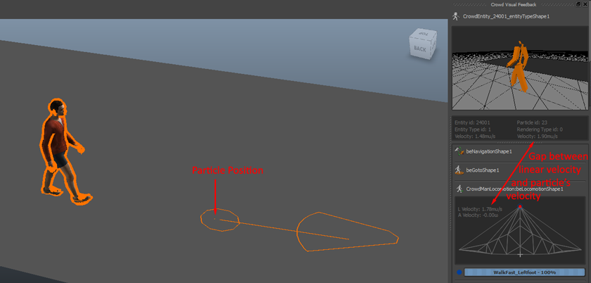

To get better animation results, when using the Locomotion Behavior, characters are driven by their particles but not attached on it.
When the particle's speed and orientation are inside the reachable speed/orientation defined by the motions in the Locomotion Behavior, they usually keep up with their particles. However, if the provided motions do not enable the characters to match the particle's speed/orientation, the character may eventually get far from its particle and produce hectic moves.
To check what happens, click on a character an have a look at the Locomotion Behavior Visual Feedback.

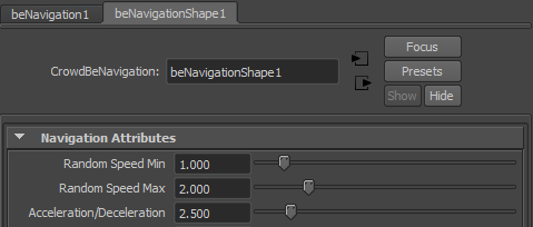

For example, if you are using the Navigation Behavior to drive your characters, you will probably need to adjust the Random Min and Max speeds, as well as the Acceleration/Deceleration parameters.
Note that there are also max acceleration parameters in the Locomotion Attributes of the Locomotion Behavior.
Note:
If you really need your characters to stay on their particles, you can choose to put your Locomotion Behavior in Direct Mode in the  Locomotion Attributes, however it may affect the animation quality.

If they cannot turn, you probably forgot to add turning motions in your locomotion, or forgot to add mirrored motion clips for each turning motions.
Locomotion Model including only turn left motions Locomotion Model with mirrored motions

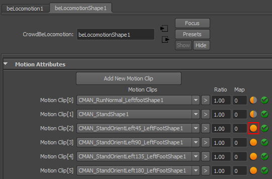

For example if your set of motions include only turn left motions, you should activate the mirror motion on them, click the  yellow hemisphere icon so that it becomes a yellow ball.
You should also check that there is no warning in the Script Editor about missing mirror mapping in your character file, otherwise the mirrored motions will be ignored.

You should either provide a rest motion or uncheck the "create neutral animation if needed" in the Locomotion Attributes.

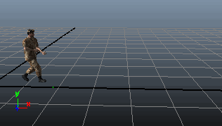

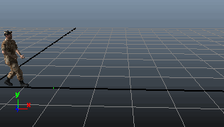

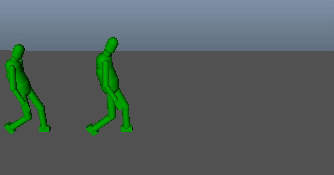

A prerequisite of this algorithm is the fact that footprints are defined for each motion in the Locomotion Behavior and these motions only contain one and only one walk cycle (i.e. 2 footsteps for a biped, or more generally one support phase per channel). The only exceptions to this rule are the neutral / starting motions.
If the motions cannot be used for synchronization,  you will experience problems like playing the same feet twice or bumps (see below).
Check Setting Footprints on your Motions for full details.
Locomotion including a motion with wrong footprints
Same locomotion with correct footprints

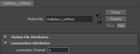

In order to use different motion styles, you need to use Locomotion Channels on your Motion Clips to avoid mixing motions from different styles together.

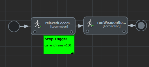

Instead you should create a separate Locomotion Behavior for each style, and switch between them using triggers (in the below example the trigger is based on current frame, but it could be linked  to the velocity of your character or whatever...)
Switching between 2 Locomotion Behaviors using triggers
Result of the above setup, playing styles one after another

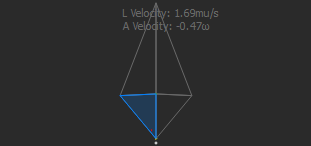

At which linear speed should I do my turn motion relative to other motions?

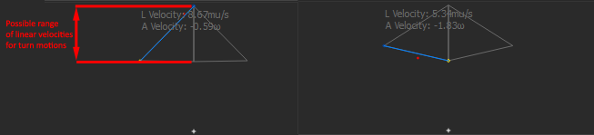

As a general rule, the linear velocity of your turn motions should not be greater than the fastest of your motion, nor lesser than the slowest one.
It also seems logical that the turn motions are closer to the slowest motion, as you are supposed to slow down when you turn.
In extreme cases (when the slowest and fastest motions are really far), you will not get a vertical line separating your triangles.
This is a really bad configuration because it means that the blend of motions to get a "go straight motion" will mainly be done between two turn motions.
In this case, you'll need to add a straight motion around the same linear speed as your turn motions in order to enhance the model.
