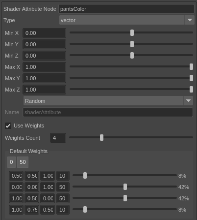

Vector Shader Attribute Properties
Min X/Y/Z The minimum vector value of the Shader Attribute. This is only available when the Mode is set to Random, which means that the value is randomly drawn between the *Min *and the *Max *values.
Max X/Y/Z The maximum vector value of the Shader Attribute. This is only available when the Mode is set to Random, which means that the value is randomly drawn between the *Min *and the *Max *values.
Mode Specify if the value is random, read from the PP attribute given by PP Name.
Attribute Name The name of the Golaem or PP attribute from which to read the value of the Shader Attribute. This is only available when the Mode is set to Attribute.
Use Weights When checked, vector values are picked according to their weight. This is only available when the Mode is set to Random. The weight values depend on the Rendering Type selected in the Rendering Types Panel. If no Rendering Type is selected (or the root "Rendering Types" item is selected), the weights displayed are the default weights. If a Rendering Type is selected, the weights displayed are the weights of the Shader Asset in that Rendering Type. Weights can also be changed directly in the Rendering Types Panel with sliders.
Weights Count The number of weights when Use Weights is checked. The minimum is 2 values.
To change the weights of the whole group to the same value, hold Shift while dragging the weight slider of one of the items in the group, or hold Shift and press Enter after having entered the weight value in the item's text box.

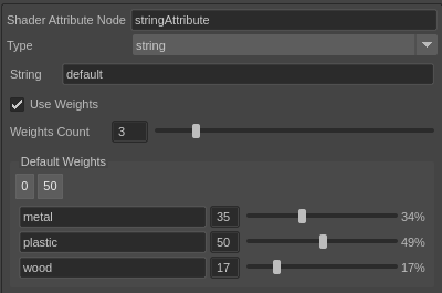

String Shader Attribute Properties
String The string value of the Shader Attribute.
Use Weights When checked, string values are picked according to their weight. The weight values depend on the Rendering Type selected in the Rendering Types Panel. If no Rendering Type is selected (or the root "Rendering Types" item is selected), the weights displayed are the default weights. If a Rendering Type is selected, the weights displayed are the weights of the Shader Asset in that Rendering Type. Weights can also be changed directly in the Rendering Types Panel with sliders.
To change the weights of the whole group to the same value, hold Shift while dragging the weight slider of one of the items in the group, or hold Shift and press Enter after having entered the weight value in the item's text box. When using attributes to feed Shader Attributes, keep in mind that the Golaem or PP attributes must be exported in the Simulation Cache.

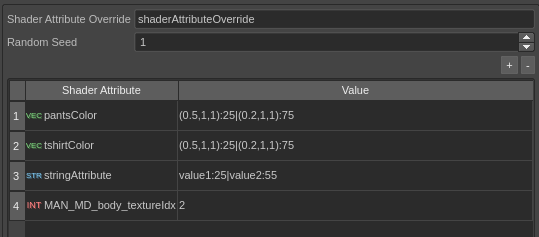

Shader Attribute Override Node
A Shader Attribute Override Node lets you override the values of one or more Shader Attributes. It can be connected to an Asset Group node.
Name
To edit the name of the Shader Attribute Override Node, edit the text box and press Enter. If a node with the same name already exists, a number will be added to the name, as it must be unique.
Random Seed
The random seed is used to change the distribution of override values for each entity.
Shader Attributes Table
The table lists the shader attributes that are overridden by this node. Each row contains:
Shader Attribute The name of the shader attribute being overridden. The icon indicates the type of the attribute (Int, Float, Vector, or String). A warning icon is shown if the shader attribute is not found in the character.
Value The override value for the shader attribute. The value can be a single value matching the attribute type, or multiple weighted values separated by |, optionally with percentage weights using the value:percent format (e.g. red:50|blue:30|green:20). A warning icon is shown if the expression is invalid. The syntax is displayed in the tooltip.
To add shader attributes to the override, click the + button and select from the available shader attributes. To remove an override, select the row and click the - button.
