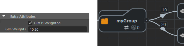

A Maya Group translates into an Asset Group Node. The Asset Group Node parameters (weights, LOD Levels, Geometry Tag) can be driven by several extra attributes on the Maya Group.
To set its LOD Levels, you can add a string extra attribute named glmLodLevels which can take comma separated values such as "lod0,lod1".
The geometryTag can be driven by a string extra attribute named glmGeometryTag which can contain information such as "previz, render".
If a Maya Group has an extra custom boolean attribute named glmIsWeighted and set to 1, its corresponding Asset Group Node will be automatically weighted. If it also has a string attribute named glmWeights, the values separated by ; will be assigned as default weights to its children.

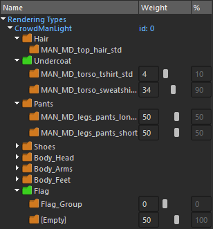

Rendering Types determine how the Geometry Assets are distributed to Golaem Characters, thus defining their appearance and creating visual diversity. Rendering Types let you define populations or groups of entities by adjusting weights on Geometry Assets, describing the likeliness  of their occurrence.
Example of Rendering Types created from a Crowd Character
Once defined, Rendering Types can be assigned to Entity Types. To understand the relationship of Rendering Types with other Golaem Crowd types, it is strongly recommended to visit the Main Concepts page for a practical example.
Relationship between Crowd Characters, Rendering Types & Entity Types
Note that you can create as many Rendering Types as you'd like for a same Character. They will all use the same set of Geometry Assets, as defined in the Main Workspace. If no Rendering Type is defined, the default weights defined in the Main Workspace will be used.
A Rendering Type defines the weights of all the weighted Asset Group nodes.
Golaem Character Maker - Rendering Types View
Each Rendering Type is displayed as a tree containing all the Asset Group nodes of the Character. Weighted Asset Group or integer Shader Attribute nodes display the weight of each of their child nodes (see figure above) and their relative percentages. Groups with weights that are different from their default weights (overridden weights) are displayed in green.
Changing weights
To change the weight of an item in a weighted Asset Group or Shader Attribute node, move its slider or enter the exact value in the text box. To change the weights of the whole group to the same value, hold Shift while dragging the weight slider of one of the items in the group, or hold Shift and press Enter after having entered the weight value in the item's text box.

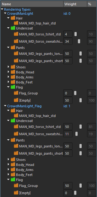

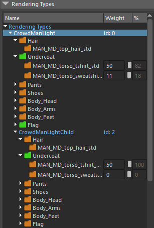

Child Rendering Type
A Child Rendering Type is a copy of its parent Rendering Type which modifies only some of its weights and leaves the other weights identical to the parent. It can be viewed as a variation of a Rendering Type. Groups that override weights in a Child Rendering Type are displayed in green.
In the example below, the Child Rendering Type CrowdManLightSummer has the same assets as its parent Rendering Type, CrowdManLight, except for the Undercoat Asset Group where only t-shirts are allowed (sweatshirts set to 0) and the Pants Asset Group where only shorts are allowed (long pants are set to 0).
Child Rendering Type Example
