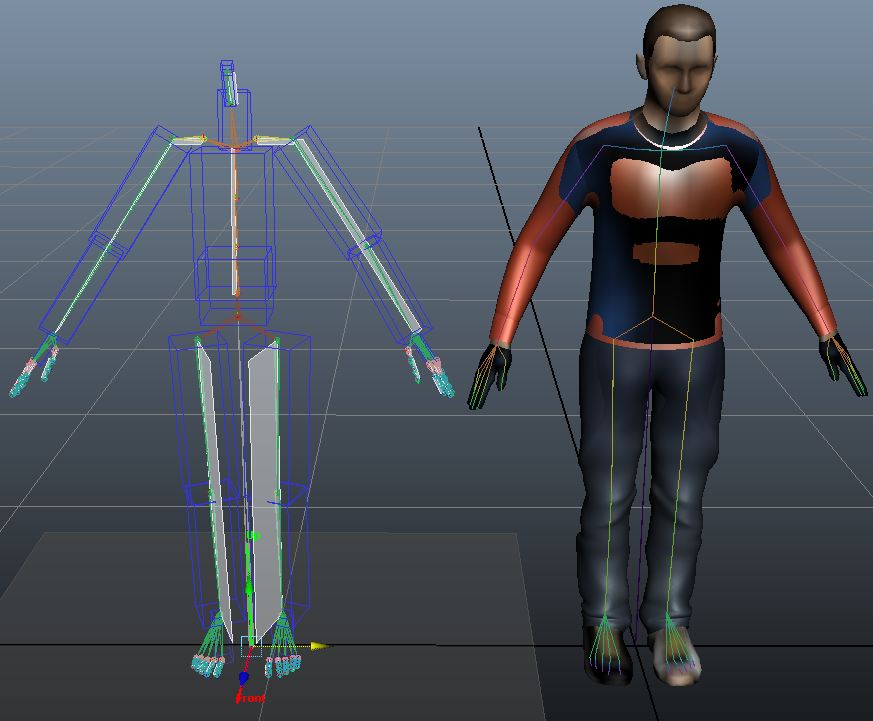

Whenever a character file is created or loaded, the Character Maker will also create a Character Maker Locator in Maya.
Caution:
Note that the Character Maker Locator will be created on top of your Maya character, you can move it using Maya Move Tool if you want to compare them, as in the image below.

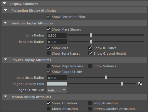

CONFIGURATION
Character File Attribute
Enable Display Show/hide the Golaem Crowd skeleton. Note that the Character Maker Locator display can be enabled/disabled from the Character Maker Toolbar.
Character File File path of the displayed Character File. Open the Character File in the Character Maker by clicking on
Display Attributes
Perception Display Attributes
Show Perception Bbox Show/hide the perception bounding box. The Perception Shape is defined in the Character Maker and can be overridden in the Entity Type.
Skeleton Display Attributes
Show Maya Shapes Show/hide the Skeleton Display shapes used as Maya primitives. See the Skeleton Display Properties.
Bone Radius Changes the size of the displayed bones, which is also influenced by Maya's Joint Size display parameter.
Bone Axis Radius Changes the size of the displayed bone axes, which is also influenced by Maya's Joint Size display parameter
Show Axes Show/hide the Up and Front axis.
Show IK Planes Show/hide the character IK Normal Planes.
Show Bone Names Show/hide the name of the bones according to the ones displayed in the Character Maker.
Show Ground Height Show/hide the Ground Height Plane.
Physics Display Attributes
Show Maya Volumes Show/hide the ragdoll volumes used for Physics simulation as Maya primitives. See Bone Physics Properties.
Show Ragdoll Volumes Show/hide the ragdoll volumes used for Physics simulation, see Bone Physics Properties.
Show Ragdoll Limits Show/hide the Lower and Upper Limits of the joint physics properties, see Bone Physics Properties.
Joint Limits Radius Changes the size of the Ragdoll Limits display, which is also influenced by Maya's Joint Size display parameter.
Ragdoll display color Changes the color of the Ragdoll Volumes display.
Ragdoll Limits Axis Changes the axis on which to display the Ragdoll Joint Limits
Motion Display Attributes
Show Animation Show/hide the loaded animation in the character maker on the Golaem Crowd Locator.
Loop Animation If enabled, the animation will not stop when fully played, it will restart at the beginning.
Mirror Animation If enabled, the mirrored animation is played.
For mirror animation to work properly, the mirror must be correctly configured on the skeleton mapping, as explained on this page.
Preview Additive Animation If enabled, only the variations in the animation are played, relatively to the neutral stance displayed in red. It provides a preview of the animation if used in Additive Blend Mode in a Motion Behavior.
