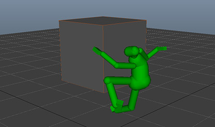

A Crowd Rigid Body is a locator which can be used as a kinematic or dynamic collider in a Physics Locator.
Example of a Maya cube used as Rigid Body collider.
If a DAG Object is selected when the Crowd Rigid Body is created, it will automatically use this DAG object as source of the In Transform attribute. If several objects are selected, only the first selected object is used.
When a Crowd Rigid Body is created it is automatically added as a collider to the Crowd Manager Physics Locator.

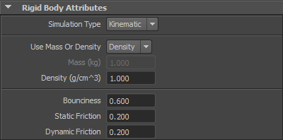

| Simulation Type |
| Use Mass Or Density / Mass / Density | Mass or the density |
| Bounciness | Bounciness coefficient |
| Static Friction | Friction when the Rigid Body is at rest |
| Dynamic Friction | Friction when the Rigid Body is in motion |
The Simulation Type attribute can be keyframed to change the physics mode during simulation.

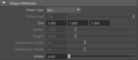

| Shape Type | Collision shape type, can be Box, Sphere, Capsule, Convex Hull,
Triangle Mesh or Heightfield. If the shape type is set to Triangle Mesh, the collision trigger part will work with the Convex Hull. If the shape type is set to HeightField, there will not be collision trigger nor in viewport display |
| Vertex Limit | If the Shape Type is set to Convex Hull, it specifies the maximum number of vertices to use for the convex hull |
| Size | If the Shape Type is set to Box, it specifies the length, width and height of the shape |
| Radius | If the Shape Type is set to Sphere or Capsule, it specifies the radius of the shape |
| Height | If the Shape Type is set to Capsule, it specifies the height of the shape |
| Subdivision Width | Number of subdivisions to use for the heightfield |
| Subdivision Depth | Number of subdivisions to use for the heightfield |
| Inflate | Inflate the shape |
| Collision Id | Id that is used by the Physics Collision triggers to filter collisions on rigid bodies |
| Collision Color | Color that is used by the Physics Collision triggers to filter collisions on rigid bodies |
