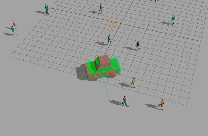

An External Entity Locator is a Golaem Entity that tracks a Maya mesh or group of meshes. The External Entity Locator is taken into account in avoidance when using a Navigation Behavior, in perception and Sensor Channel Operators as a voxelized geometry. This locator has a position (which is obtained for a tracked Maya DAG object) and a radius for avoidance, and a voxel representation which approximates the mapped meshes for perception and sensor ChOps. This node is useful when to avoid moving external Maya objects. It's recommended to use the NavMesh representation if the geometry is static.
/ right
click / External Entity LocatorIf a DAG Object is selected when the external entity locator is created, locator will automatically use this DAG object as tracked object. If several objects are selected, only the first selected object is used.

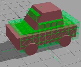

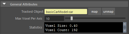

| Tracked Object | A Maya mesh or group of meshes, tracked in position and orientation. Each mesh must be convex and closed, with its normals pointing outwards, otherwise the voxel approximation might be incorrect. |
| Max Voxel Per Axis | The maximum voxel count along each axis. The voxel computation will choose the voxel count within the given limit that best approximates the tracked Maya geometry.
| Statistics | Displays the computed voxel size and the total number of voxels that approximate the input geometry (according to the Max Voxel Per Axis parameter). |
| Display Color | Defines the color of the External Entity Locator in Maya's viewport. |
| Display Color Alpha | Defines the alpha color value of the displayed voxels. |
| Display Voxels | When enabled, draws the voxels in Maya's viewport. |
