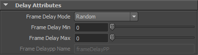

Delay Attributes
Frame Delay Mode This attribute allows a choice of two Frame modes:
  • Random: Randomly set the delay frame count value between the specified "Frame Min" and "Frame Max" bounds (this attribute is influenced by the random seed of the Crowd Manager)
  • Per-Particle Attribute: Use the "Framepp Name" attribute to get the name of the float per-particle field of the relative particle system, containing the delay frame count value
Frame Delay Min See Random mode option of the Frame Mode above.
Available only when the Frame Mode is set to "Random"
Frame Delay Max See Random mode option of the Frame Mode above.
Frame DelayPP Name Name of the float per-particle field of the relative particle system, containing the Frame value which will be used to delay the Behavior graph (for more explanation about how to use ppAttributes, see ppAttributes Handling)
Frame value is set to 0 if the ppAttribute name is empty or invalid
Available only when the Frame Mode is set to "Per-Particle Attribute"
