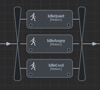

Example
The following example describes a NoOrder Operator used to animate an Entity by playing 3 different animations (using Motion Behaviors). The entity will first play any of the available animations, then play another animation (different from the first one) and finally play the last remaining animation. In the end, the Entity will have played all the animations once in any of possible orders ( IdleQuiet > IdleAngry > IdleCool or IdleQuiet > IdleCool > IdleAngry or  IdleAngry > IdleQuiet > IdleCool or ...).
A NoOrder Operator processing a sequence of 3 idle animations in a random order
