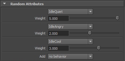

Random Attributes
Random Attributes of a Random Operator
Weight Configure an existing connection, by changing:
  • The related weight value.
  • The target behavior, e.g. the Behavior to process if the connection is selected (this Behavior must be a child of the parent Behavior Container). Selecting the "no behavior" option removes the connection and deletes the related entry in the Random Attributes.
Add Create a new connection between the Random Operator and a given Behavior (this Behavior must be a child of the parent Behavior Container). A new entry "Weight" is then added in the Random Attributes, allowing to configure the weight associated to the connection (default value is set to 1.0).

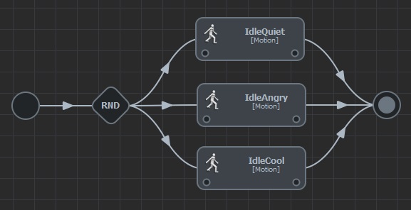

The following example describes an alternative selection between 3 Motion Behaviors (with weight values set up as shown in the Random Attributes description).
A Random Operator processing a random selection between 3 idle animations
When the Random Operator is reached, each connections will be taken into account for random selection depends on their weight.
