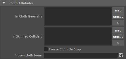

A Cloth Behavior defines the following specific attributes. For common attributes see Behavior Common Attributes.
Cloth Attributes
In Cloth Geometry List of meshes attached to a nCloth which will be simulated. All those meshes must be attached to a nCloth node and must be listed as Meshes in the Geometry Tab of the relative Character
File
In Skinned Colliders List of meshes attached to a nRigid which will be simulated. All those meshes must be attached to a nRigid node and must be listed as Meshes in the Geometry Tab of the relative Character
File
Starting Duration Starting duration for the cloth simulation. During the starting duration, the "Input Mesh Attract" parameter of the simulated clothes goes from 1 to 0, allowing for a smooth cloth simulation start.
Stopping Duration Starting duration for the cloth simulation. During the stopping duration, the "Input Mesh Attract" parameter of the simulated clothes goes from 0 to 1, allowing for a smooth cloth simulation stop.
Freeze Cloth On Stop If checked, the cloth will keep the shape it has when the stop trigger is set true. To go back to the skinned version of the cloth, it will be needed to start again a cloth behavior and stop it without this option checked.
Frozen Cloth Bone When the Freeze Cloth On Stop option is checked, this lets you freeze the cloth relative to the given bone rather than in world space
Every objects linked in the "In Cloth Geometry" and "In Skinned Colliders" lists must have the same names in the Character File (.gcha), in the Geometry Tab of the Character Maker (beware of namespaces).
If a nCloth listed in the "In Cloth Geometry" list has constraint with a nRigid object, the nRigid object must be in the "In Skinned Colliders" list for the constraint to work.
Note that meshes can be filtered by the asset repartition ot the Entities Rendering Types. In such a case, the clothes will only be simulated on the entities that get the cloth objects.
